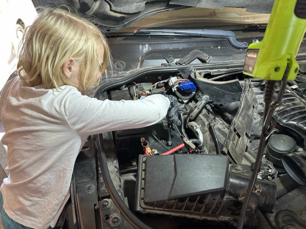

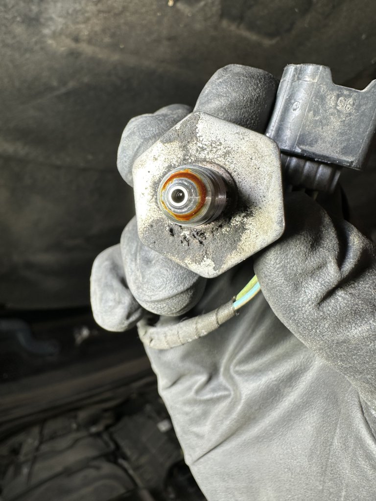

Couldn’t wait for an answer… Got the new sensor in, even though the old sensor looked pretty filled with junk, the new sensor did not fix the problem. I have a new low pressure sensor too. Maybe I’ll put that in and see what happens.
