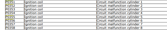

I have a FIXD code reader that displays the following codes.
P0357
P0355
P0353
P0351
These are all ignition coil related issues and appear to be the driver's side of the block.

Yep, those code are for individual cylinders:
Some folks reported issues with grounding from the head leading to ignition issues, so I'd probably start there. If you swap coils side to side, do the codes follow the coils, or stay with the head?
