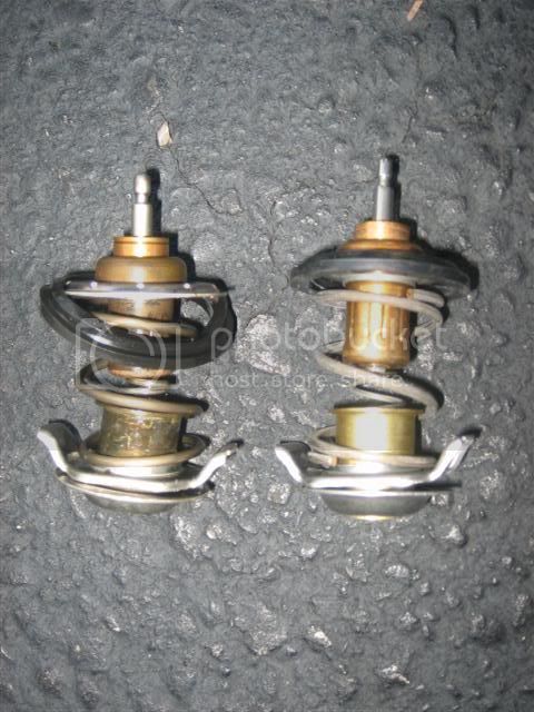

JackMac
Aug 7, 2006
673
I just did the DIY thermostat replacement yesterday. Thank you to those who documented the process.
Just wanted to add two items.
1) Putting the new thermostat in place was difficult due to spring pressure, as others have noted. After trying for way too long, I decided to remove the 3 hose connections to the thermostat housing, and took the housing and new thermostat over to the workbench. 5 minutes later, it was done. Much easier to work with on a bench than under the hood.
2) For those who had questions about assembly, below is a pic showing the old unit and new one, in the proper configuration. You can see how the old rubber ring had separated.
bbyer
Aug 15, 2008
895
151
Alberta
****** / hat matters
Ok swapping mine out today. Problem, when I went to undo the old one, wasn't expecting the tension and it all went flying. Trying to assemble new one correctly? Help?
I think it is small spring, large side up, then the little ****** on the top of the thermostat shaft, followed by the big spring under and the retaining piece then that locks underneath the big spring? Anyone? Just not sure on the small spring and the ****** placement...
This link also has some good pdf's re the thermostat change and makes reference to the ******/hat in picture 5A. The A is because it got forgotten about in the first attempt to replace the thermostat.
