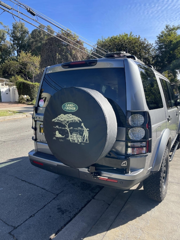

Got this spare tire cover in from Rovers North... fit is spot on. pretty damn pleased with the results:
Hey what do you think about the tire carrier?
Loving it thus far. It's mostly a visual thing, but getting the spare in and out with the larger tires was a huge pain before. Also I want to put a drawer system in, which would've been tough with the underbody mounted spare.
Love it. Is that the Large size? I've wanted one for a while but didn't know what size would fit 265/65/18.
It's the large size and it fits perfectly (I'm running 265/65/18's as well) !

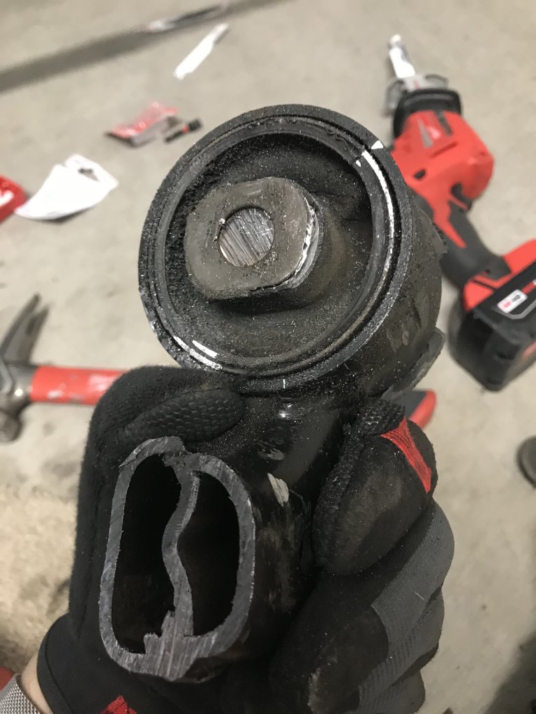

Started my lower control arm install last night. Passenger side went quickly with no drama, so I started on the drivers side... different story.
The rear bolt was seized inside the bushing. Had to cut it off. Nothing else would work. This car isn’t even a rust bucket car lol.

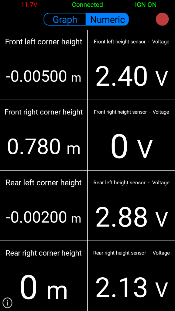

I smoke tested the intake and vacuum lines for giggles (no leaks) and tested my latest hack of the ECO system.
I also checked the values of my ride height sensors and this is what I have:
Front right seems to need-a-replacing. Also, obviously the screen shot doesn't capture it, but the rear right corner height's number was changing while stationary.
What does the group think?
