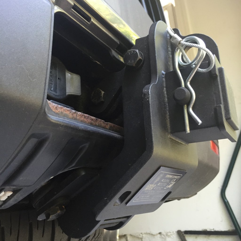

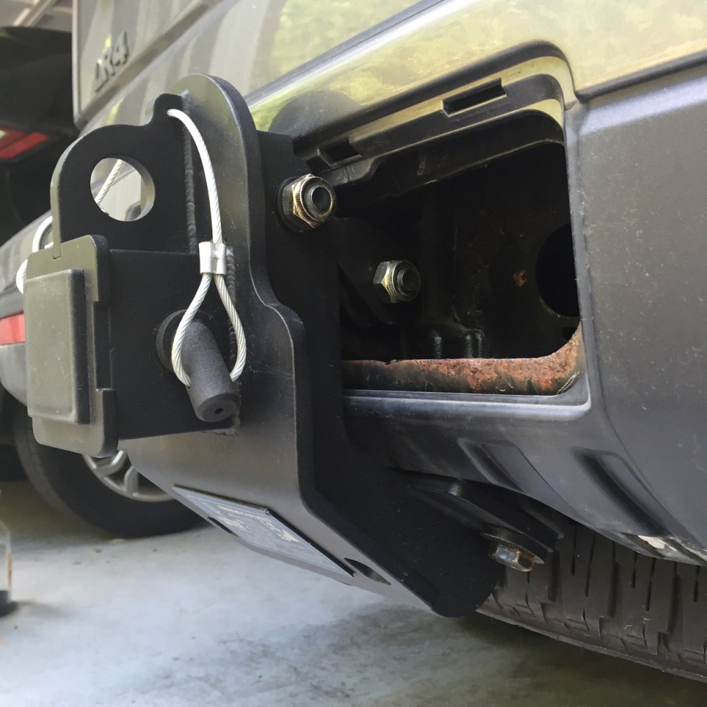

I have not seen an Rhinohitch in person, but my understanding is that they attach to the factory receiver in the same manner as the factory tow adapter, but then curve up to also attach to the factory recovery point. Seems like the load capability would be the same, if that is correct.
That's exactly how they mount. The sleeve at the top in the photo you shared is what slides into the recovery point loop. They send two different diameter sleeves because that opening is slightly different between the LR3 and LR4. Finally, there is an extra safety hook that clamps on so that if TSHTF you have one final bit of redundancy.

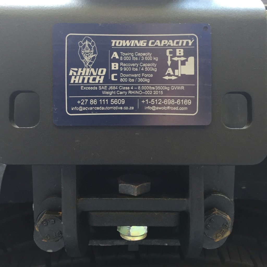

I would also like to see documentation from LRNA stating that this hitch lowers the vehicle's towing capacity. That would contradict the certified capacities of the Rhino, which exceed the towing limits and tongue weight of the OEM device and the vehicle itself.
