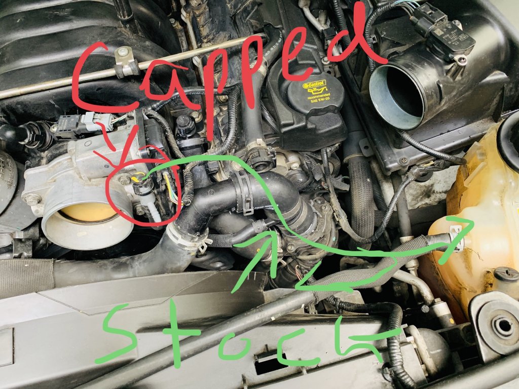

Ok so all reassembled, all good, except I screwed up and put in the wrong coolant, maybe 4 quarts worth, didn’t realize the little sticker till it was too late. So do I need to do an entire coolant flush? What are the options here? (Never realized the organic acid specific to lr)

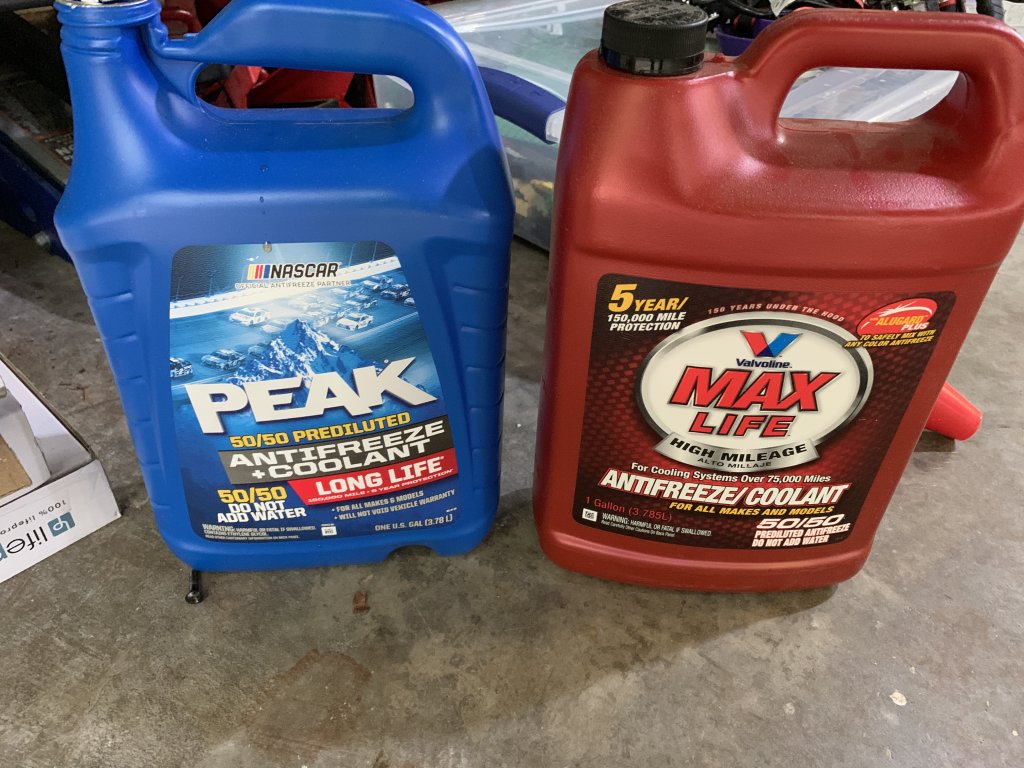

Nope so first I got the valvoline max life for all makes and models (red). Then about a bottle of peak 50/50 for all makes and models (green).
Just took for. 2 minute drive and it said overheating and switched to slug mode
One more side note after driving the coolant reservoir went from cold fill line when cold to completely full after warming up and driving

Ok so right now I capped the line in red, but now that I know what it’s for and the stock way was the lines In green and I need to redo the red to the green . Not sure but I’m guessing that’s what’s causing the overheating issue? Can’t be coolant, not that fast
Air lock. Use proper bleed procedure
