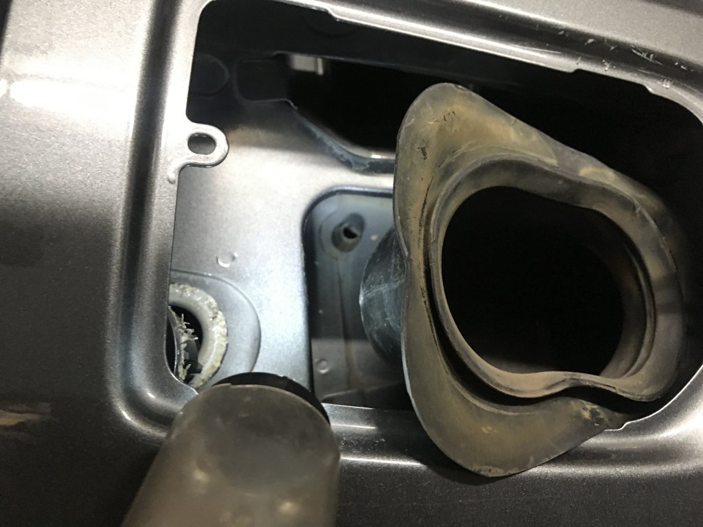

Anyone know what this little tube behind the air vent rubber does?

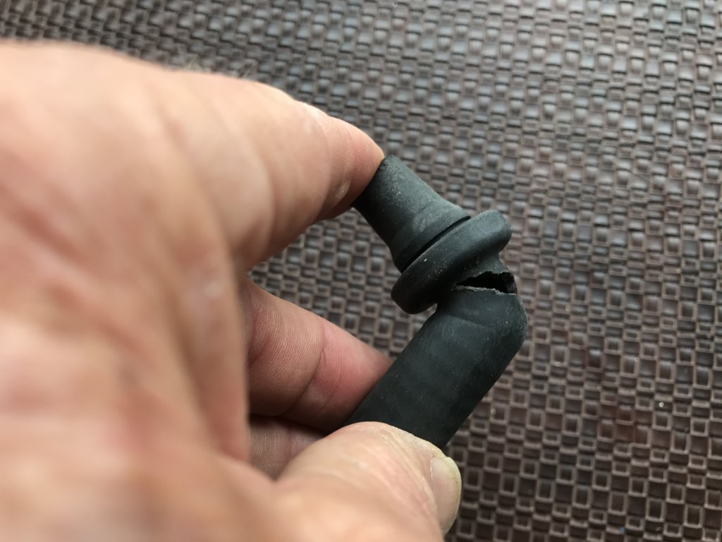

So, here you see the ruptured passenger-side sunroof drain that was pouring water down our wiring harness. On replacement I avoided removal of the Central Junction Box by using a scope to watch through the drain hole as I pushed the new hose down behind the CJB. After the ****** was in sight I ran a cable down the tube and grabbed the end with pliers, leading the ****** closer so I could pull it through into the air vent. I also used the 12mm Canadian push connector from Amazon to splice old and new tubes, avoiding dropping the headliner.
Let it rain!
