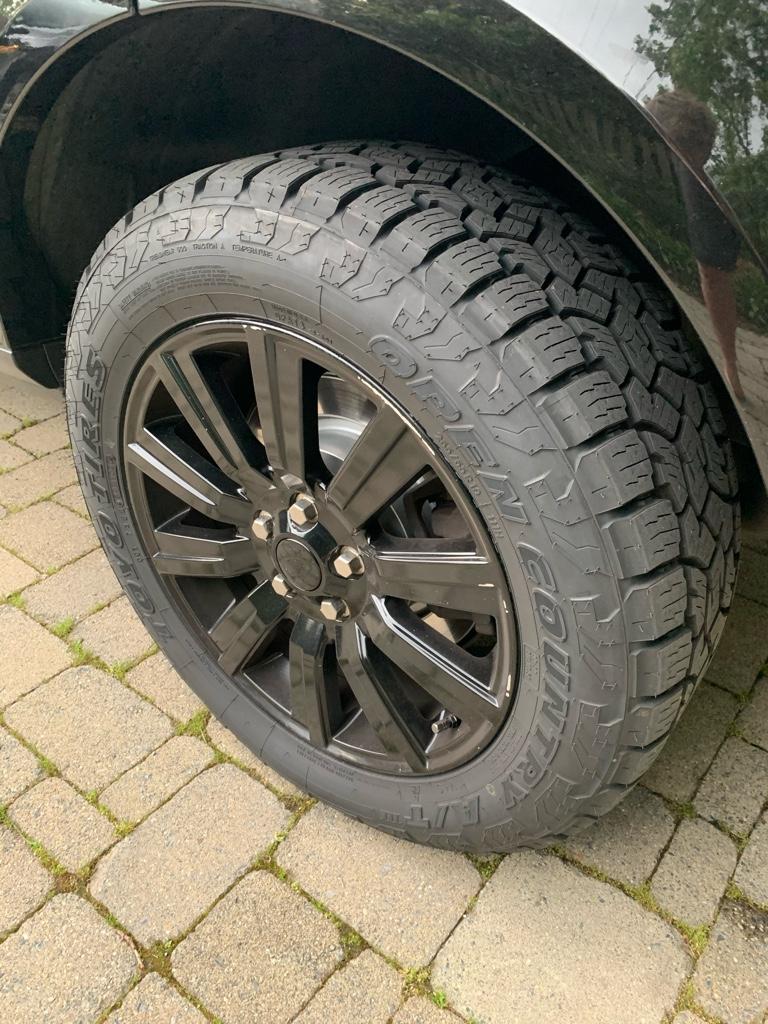

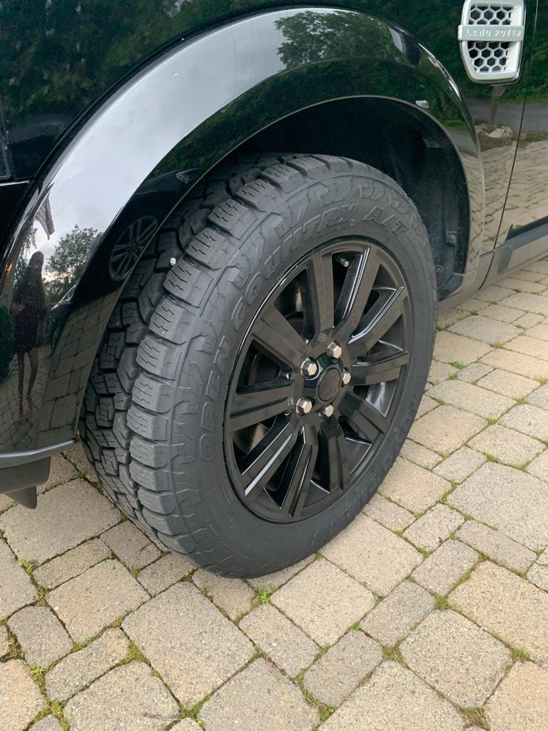

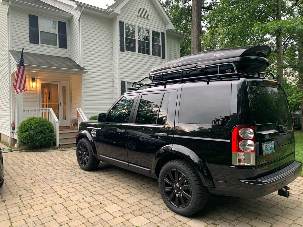

Just picked up the new TOYO Open Country AT3 for our 2013 LR4 with the challenging 19 rims. I was close to pulling the trigger on the Conti Terrain Contact A/T when I saw the new AT3 was being offered in 255/55/19.
I think they look great and so far they have been great on the road. No adventures yet! Some beach cruising scheduled later in the month, for now we’ll be pounding some pavement.
No noticeable road noise.
They are offering 500 mile returns for these new tires. I’m 200 miles in and can’t find a reason to return them yet!

Great looking tire. Dave, who is offering the 500 mile return? And do you notice any vibration or are they smooth?

Not to second guess your decision with the 55 profile, but did you see if 255/60R19 would fit as they have these listed as well for the 19”
