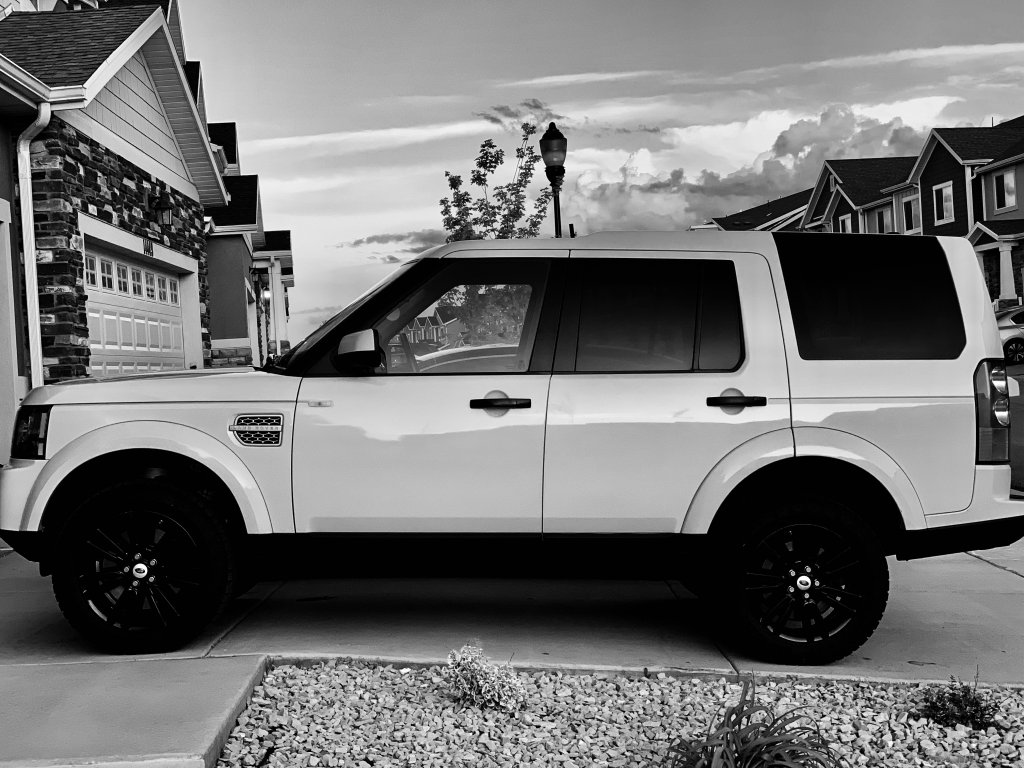

Similar to him, I stayed with stock 19” (after paying for high gloss powder coating of the original 19’s) - and went with the Duratrac in the 255/55/r19. Not a MASSIVE off-roader... mostly campaign and BLM land trails - so I was comfortable with the adequate sidewall on the duratrac. Like the off-road look and feel and teeny bit of road noise... but didn’t want mileage to suffer, and liked the idea that that tire was made for THAT truck. Something comforting in that as well.
I know with a small lucky-8 or rhino-rod air suspension lift, that some on this forum are playing with the new diratrac 265/55/r19 - hmm - or is it the 255/65/r19? Anyway - it’s BARELY beefier and rubbing may or may not occur. But there are whole threads attributed to that.
If you go with the duratrac 255/55/r19 I don’t think you’ll be bummed at all.

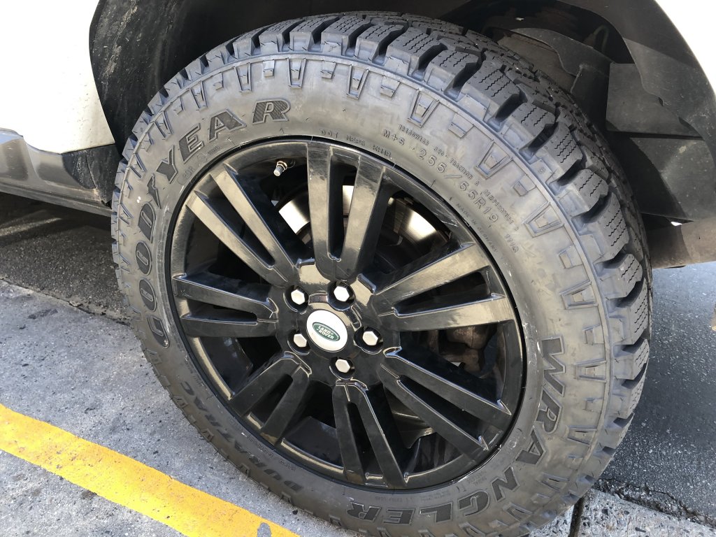

Hi there - I am on my second set of Goodyear Wrangler Duratracs. Size is 255/55/19 - the stock size tire for the 19” wheels from Land Rover.
I went with the duratracs because I wanted a beefy, off-road look (and performance), and there are very, very few rugged looking tires in this size. As one of the other posters said, most folks drop to the 18” wheel so they have access to a dozen+ rugged tires.
That said, I’m on my second set of duratracs, after going through the original continentals that came on the truck. I’m getting something like 40,000 -55,000 miles out of them. I don’t track it super closely, but my sense is they are lasting a little less than I would like, but not horribly so.
The biggest dings I hear for these tires is the lack of strong sidewall protection compared to other models. Seems like other tires are available with more layers or stronger layers in their sidewalls and or in the body of the tire. Obviously better for rocks and other off road hazards.
For me - doing camping and moderate off-road trails in blm land and lots of road driving these have been just great. Not too noisy, great off-road performance in sand/gravel and snow.

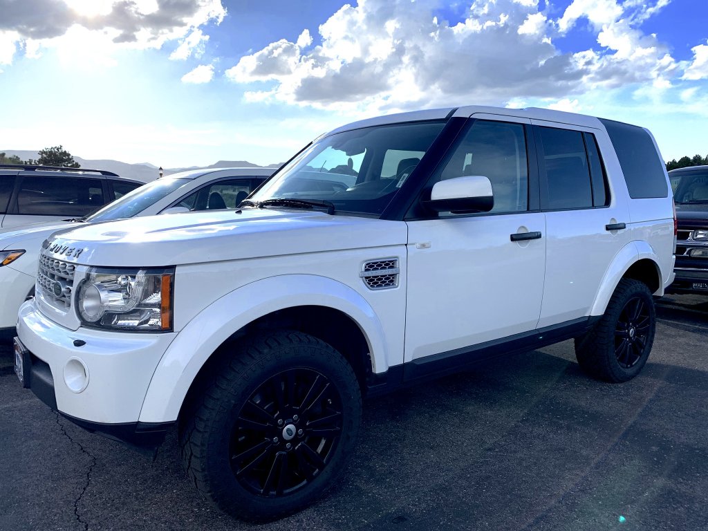

We are in a 2010 LR4. All tires are currently 19”
running Goodyear duratracs for off-roading as they were the only real option. And while we don’t rock crawl in our truck we don’t shy away from any trails here in Colorado.

Im really happy with my Duratrac 255/55R19 (stock size). I would usually run KO2 but with the 19" wheel we are limited. Low noise on the highway and great on trails and snow. Im in NorCal and they work great in the winter in the local mountains.
