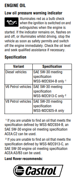

Interesting I had never seen the Land Rover specific specs that Ravenol mentioned. The only specs listed in the 2010 manual were:

this is the first time i've seen 5w-30 specced for an LR4/Disco4. This makes me think that v6 is a completely different engine from the SC v6 that we later got.

Perhaps a continuation of the old Ford 4.0L V6 they were using in the LR3? Low end engine option for a stripped out Discovery 4 in some markets?
