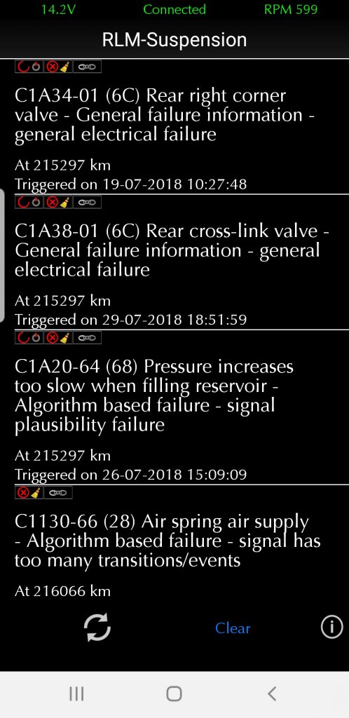

I'll check out the chart, thanks. Here is a screen shot of the fault codes that I pulled from the IID tool. I haven't cleared them yet, but might try that today.

You will want to check the air struts for leaks by spraying a solution of dish soap and water on them and look for bubbles. I don't think you can rebuild a LR4 strut (by replacing just the air spring) but new aftermarket struts are available. Fix it/them soon before it kills your air suspension compressor and do as djkaosone suggested and replace the silica or dryer in the air suspension compressor. BagPipingAndy may have a complete compressor rebuild kit for LR4 if it dies.
