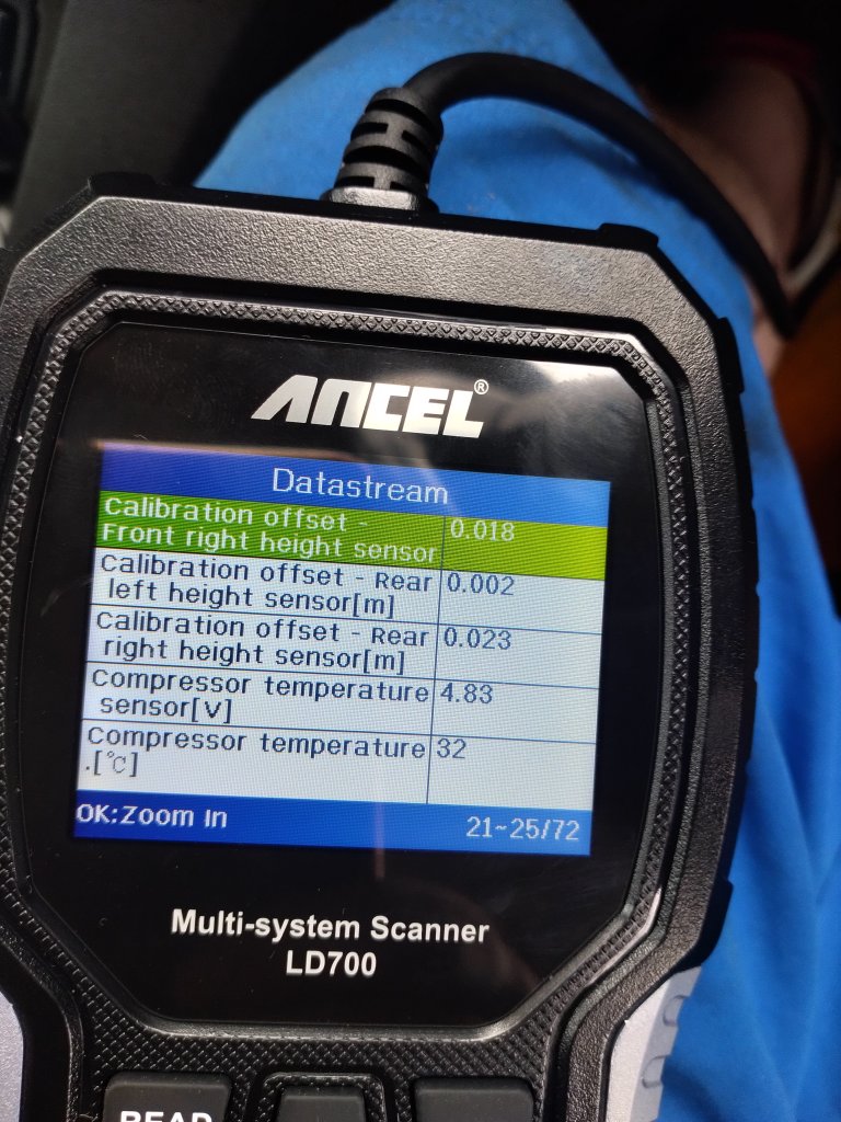

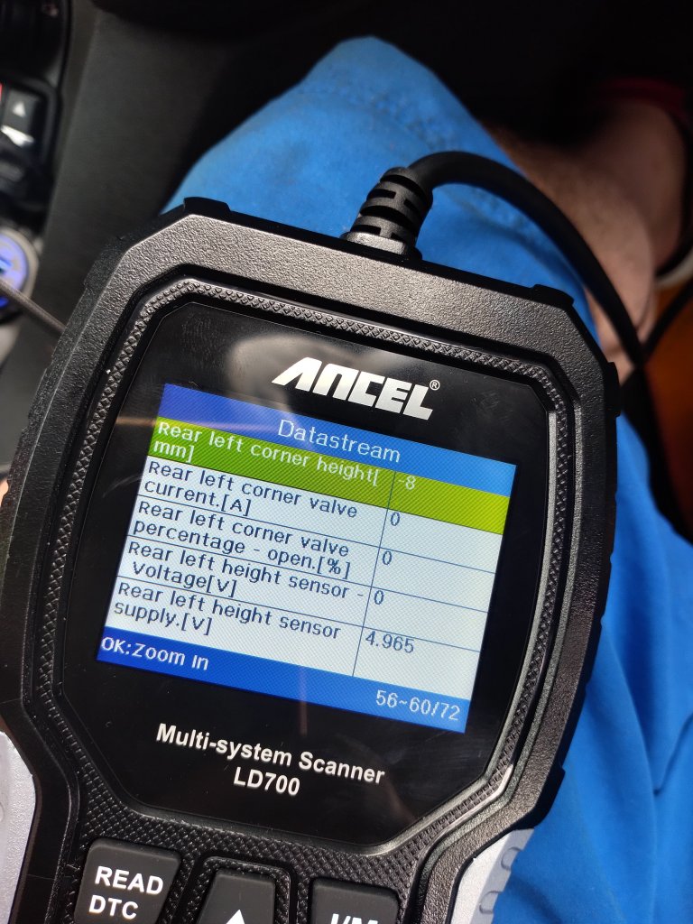

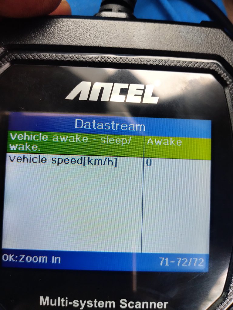

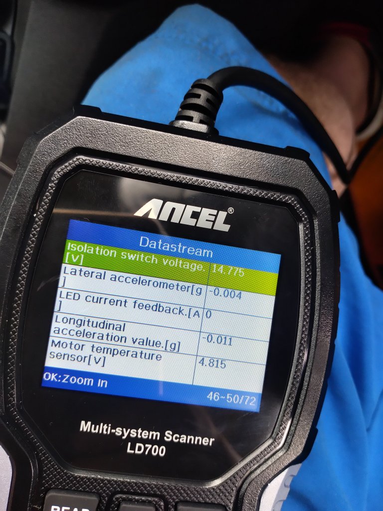

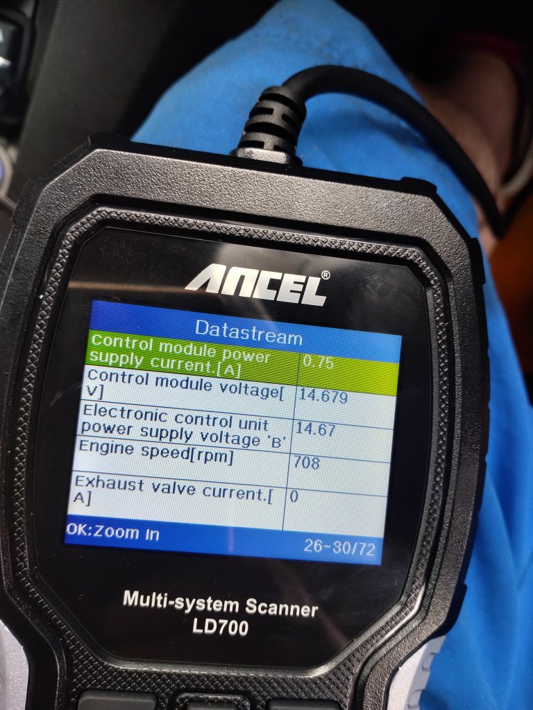

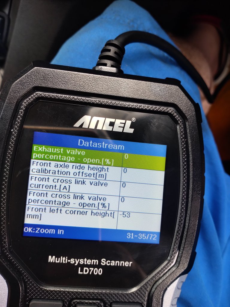

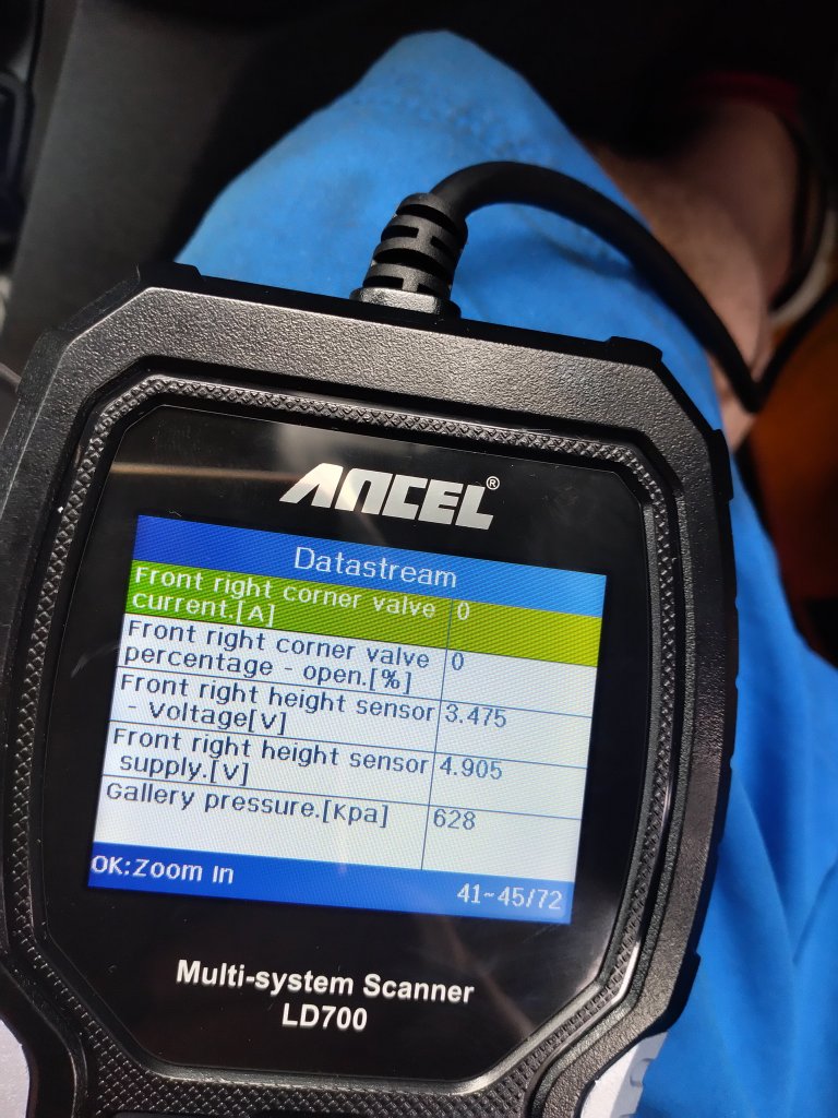

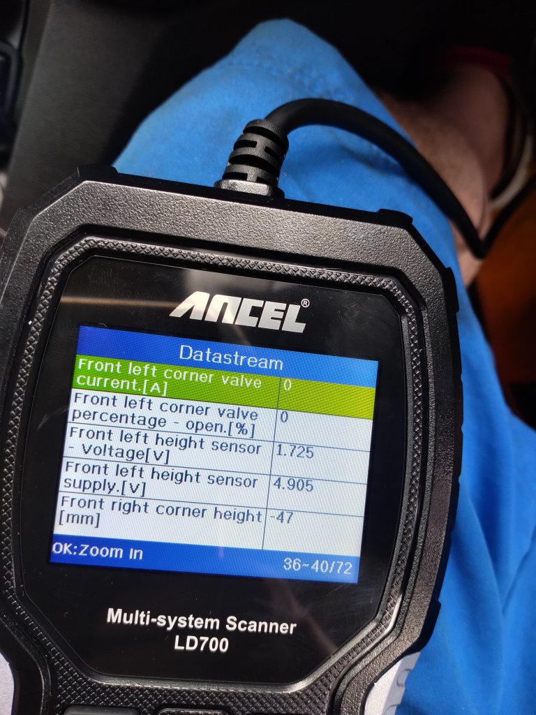

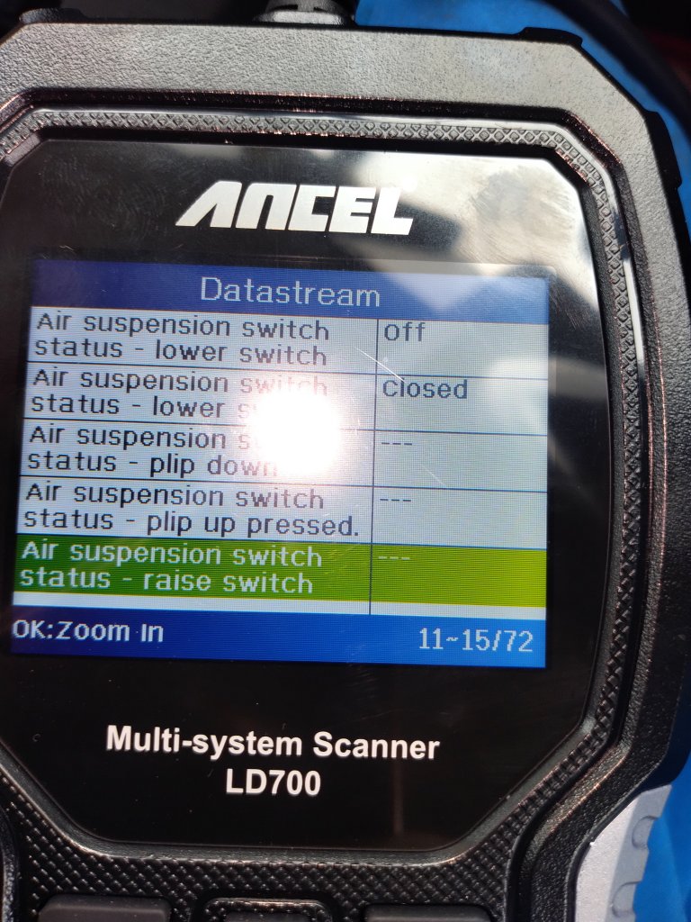

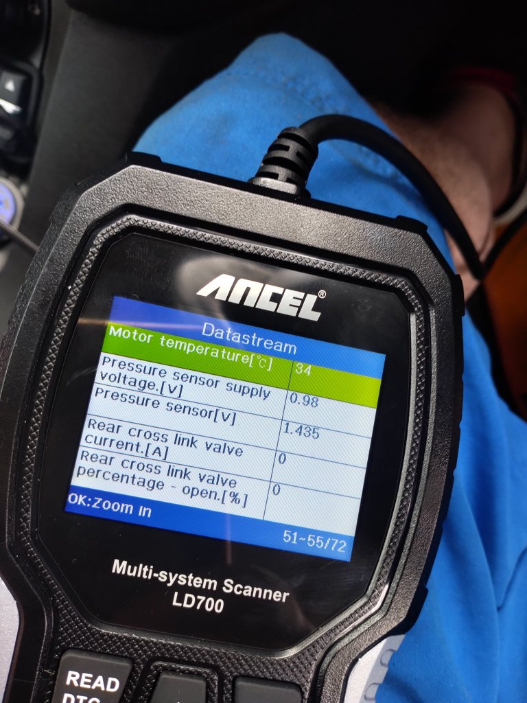

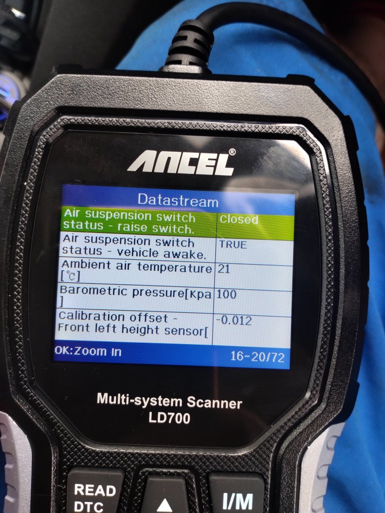

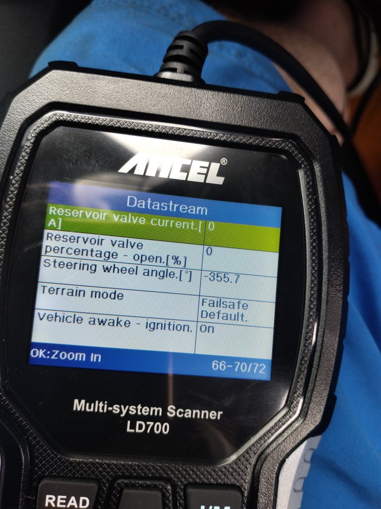

Hi all uh oh the susoension faults is showing again now replaced back left sensor and compressor compressor fault went rear sensor fault went ,bit showing again today ,pictures attached of diagnostics what else could possibly be causing this anyone know ? What should I try next ,considering it went after changing compressor and now it's back ,relay changed too all was fine .thanks all Tony

The fact the rear left sensor voltage is reading as zero would point in the direction of wiring. Can you confirm the voltage reading at the sensor itself? You should see ~5v at the sensor input - if you don't then the supply wiring is suspect. You should see a non-zero value at the sensor output, and see it vary as you move the sensor through its range of motion. If not, then it's the sensor or sensor wiring itself. If you do see voltage at the sensor output then that would point to the return wiring being suspect.
