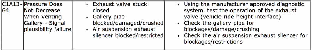

Ok guys. I have an update and I'm looking for input. I ended up ordering a compressor but it didn't come in last week. So I called a friend who owns a 12 LR4 on Saturday and talked him into letting me do a quick swap of his AMK compressor to see if that was the issue. I can literally swap a compressor in 10 min now. LoL
Sooo..... it was not the issue. I have a new compressor that was delivered but Im 99.9% sure that is not the issue after the swap with my buddies so I'm going to return it.
Screen shot from the second code on the repair manual attached -
What should I try from here? Clearly its not venting...

Im now leaning towards the rear transfer relief valve. Its right behind the drivers side rear tire. I tapped on it with a screw driver and it seemed to hold the code off for 10-15 seconds. Also these solenoid valves are electronically controlled and I have a hunch its holding off the venting.
