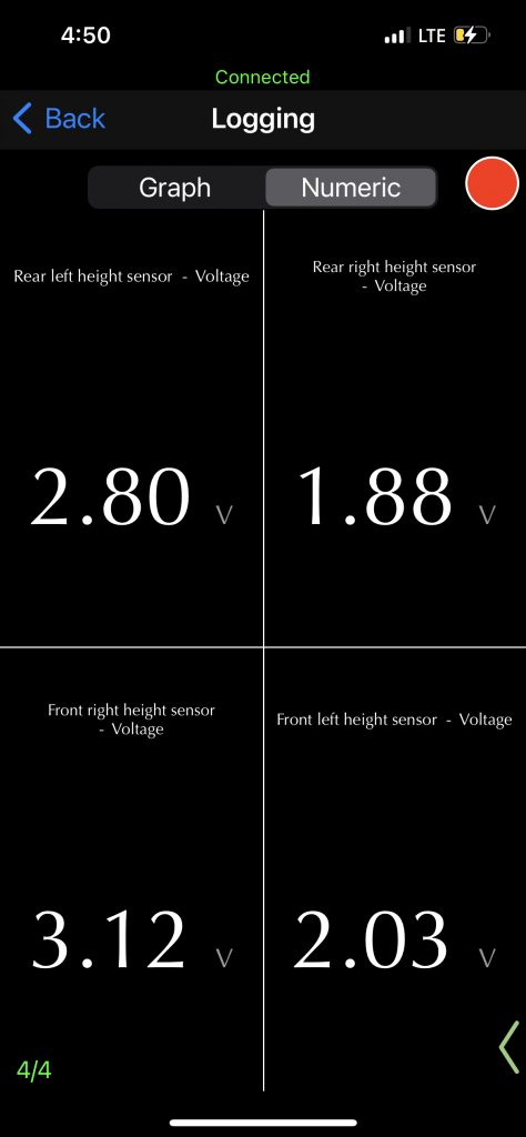

So I ran a live test on the height sensors and this is what I got. So looks like it’s the height sensor. I ordered a new one. Upon inspection it looks a little knackered. Hopefully that will solve it! Also hopefully not a wiring issueView attachment 23505

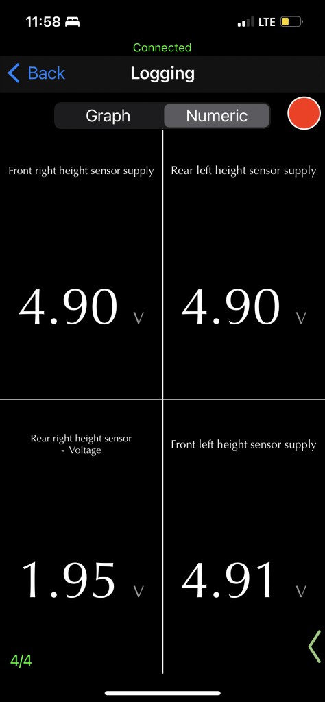

Is sensor and sensor supply two different parameters? I would go back into your live values and double check that.
All of your 4.9 volts are X height sensor supply.
The 1.95 voltage reading is just height sensor voltage.

yes, they have live values for just sensor and also sensor supply. Here’s the result
