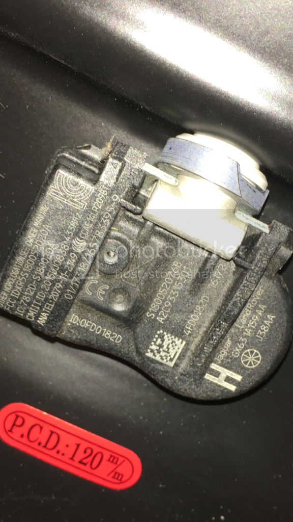

Let me know how they work, I'm in need of one for my full size spare, didn't know tire rack carried them. Thanks for the heads up
Well, I can confirm that the TPMS sensors from tire rack ($55) are working well on my MY15 LR4.
I put 5 on all 5 of my new compos with 265/60 KO2s.
PSI readings are accurate on the systems-check in the menu.
We shall see how they hold up...

The DIY method is to swap spare and one of your driving wheels, and drive around for a few miles. The spare wheel sensor will be registered in the TPMS module, and then you can swap wheels back. The faster and more expensive alternative is to visit a dealer to have the sensor's S/N registered manually via LR diagnostics. AFAIK, you cannot do that with an IIDTool, either.
backcountryLR4
Dec 21, 2016
201
109
Utah Backcountry
There was nothing done by my install guy to reset or register the new TPMS. I do not get any alerts about the spare.
Everything just worked. YMMV
