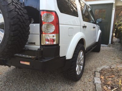

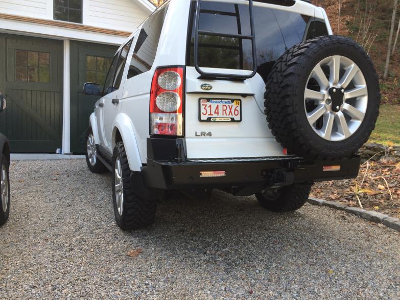

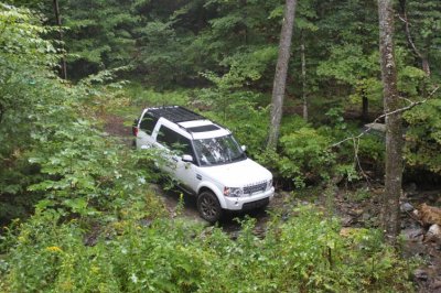

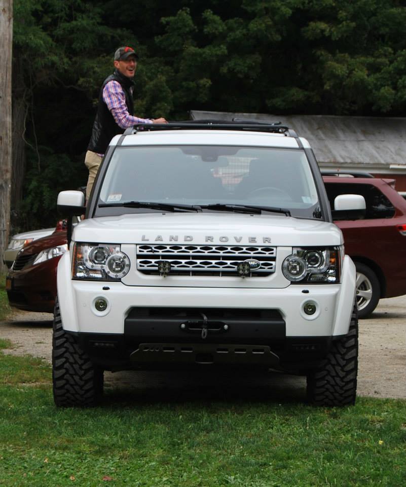

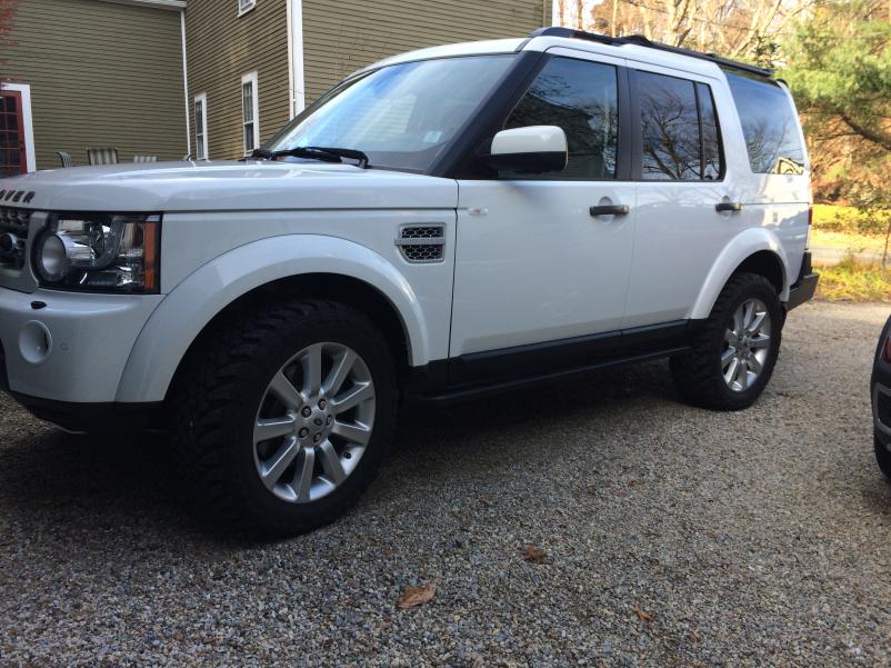

I have though I used FFRR 20" rims. It has been a year or so but if I recall correctly the RR rims have increased backspacing which enabled less spacer (only 3/4"). I run a 275/55 R20 Open country Toyo mud terrain. You may find that (or at least a year ago when I did this) there aren't many options for 20" tires. But I can say unequivocally the Toyo is fantastic. With the size I have, I do maintain a lift (adjustable rods) and I do get slight rubbing on the frame arms in the front wheel well at full steering lock, not enough to cause concern. I also carry an ECU bypass setup for airing up the air bags in case I'm off-road and something fails. The truck could not ride home on its' bumpstops with the current tire.
The primary reason I went with the 20" rim at the time was/is that they are cheap and easy to find/replace. I bought 5, in A+ condition for $400 from a fellow on this board. The downside is that you have less rim protection than a comparable 18". I've been okay with this because they are cheap/easy to find and replace, rather than refinish. I've also always liked the shoulder the LR rims have/maintain, they seem to hold the bead better but I've never compared them to the compos. Somebodies wisdom would also state that the truck rolls less side to side around town or handles sharply. But I have nothing to compare that to than the stock 19"s I keep with Blizzaks on them for the winter.
I'm happy with the setup, would only consider Compos if I could not buy the Toyo tires again.

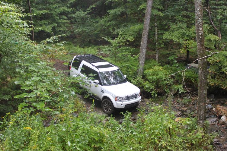

Thanks for the input. So without the adjustable rods I assume the 275/55s wouldn't be be doable? Any pics you can share?
That's correct.
Some driveway and non driveway pics.

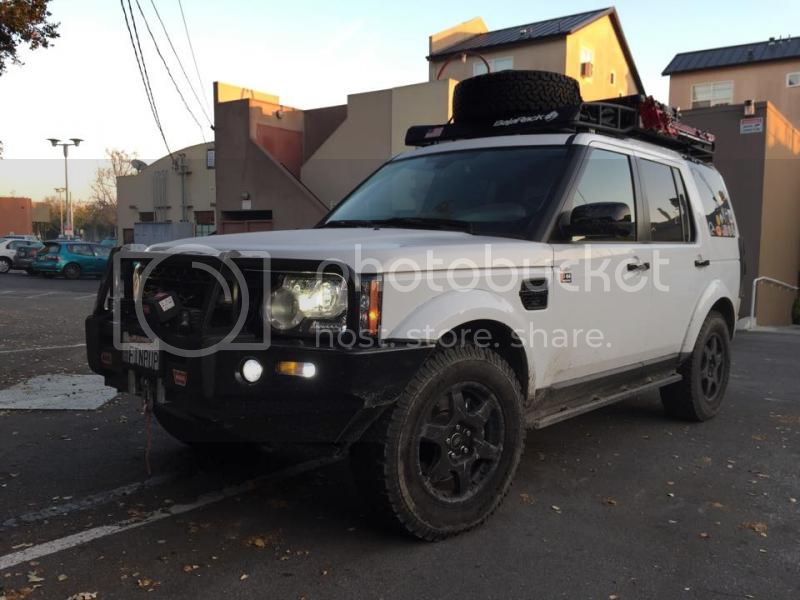

I haven't posted a photo in quite some time. As you can see got a new roof rack. Hopefully will be installing the Kaymar and custom rear swing away on Friday.

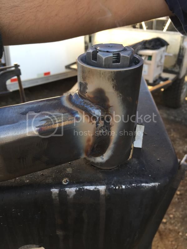

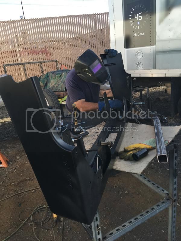

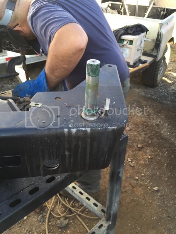

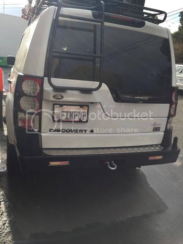

Installed the Kaymar yesterday, but it took about 16 hours - most of which was fabricating. We cut out the entire spindle system, re-welded everything, added a huge custom spindle and now building a swing away that is crazy strong.... It's going to be awesome. I will post a whole thread about this process, but we basically got rid of the spindles on the stock Kaymar and did my own on the right side. it was a lot of metal cutting, welding, and grinding. Also added a lot of custom reifnorcement, re-painted, and almost done with the tire carrier.
I will post more photos soon, but here is a teaser:

Looks good. When you coming to MA again? The salt can't wait for you... ;-)
What was the reason for the full fab job? Cutting the upper section of the swing away was pretty easy. Just trying to wrap my mind around the why.
