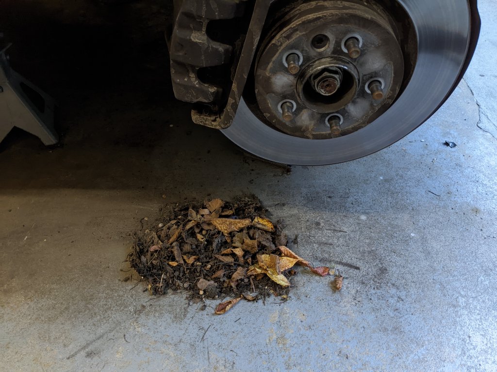

I removed the wheel and pulled the fender liner, got a nice pile of debris, along with a nerf dart.

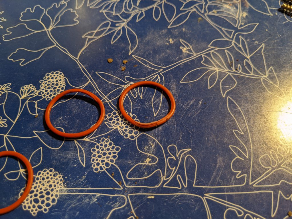

Portland, OR, USA
The solenoids for the individual corners seem stuck having pinched their respective O-rings.
I can see some desiccant powder in the housing

They sell rebuild kits for the valve blocks, but a lot of the seals in the one I got did not work because the size was wrong.
Yes, mine were close, but not quite, too. I will see if I can return them. I put the valve block back together after cleaning it, and reassembled everything - no more bubbles there. I likely could have just tightened the bubbling hose fitting and saved myself a bunch of work, but I got to tinker and gain confidence with this system. I still have bubbles from the compressor outlet, and will see if I can pick up a new air tube from the dealer, though the price is quite steep online, and I suspect more so at the local dealer. What's the chance it's the fitting on the dehydrator, and not the hose itself, that's at fault?
