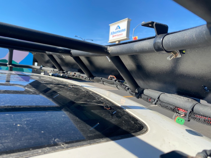

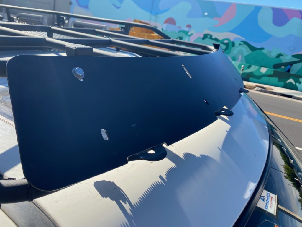

Hi Smerk, funnily enough I actually tried this exact thing a while ago and sandwiched it between the fairing and the roof rack but at the time it did not reduce the noise much. however I have since cut off 2 other square light bar mounts that were pertrouding at the top rail near the top of the fearing so maybe I should try again and check for results...
The squares can be seen in both pictures below and in the second one the the foam wrap test I mention above.

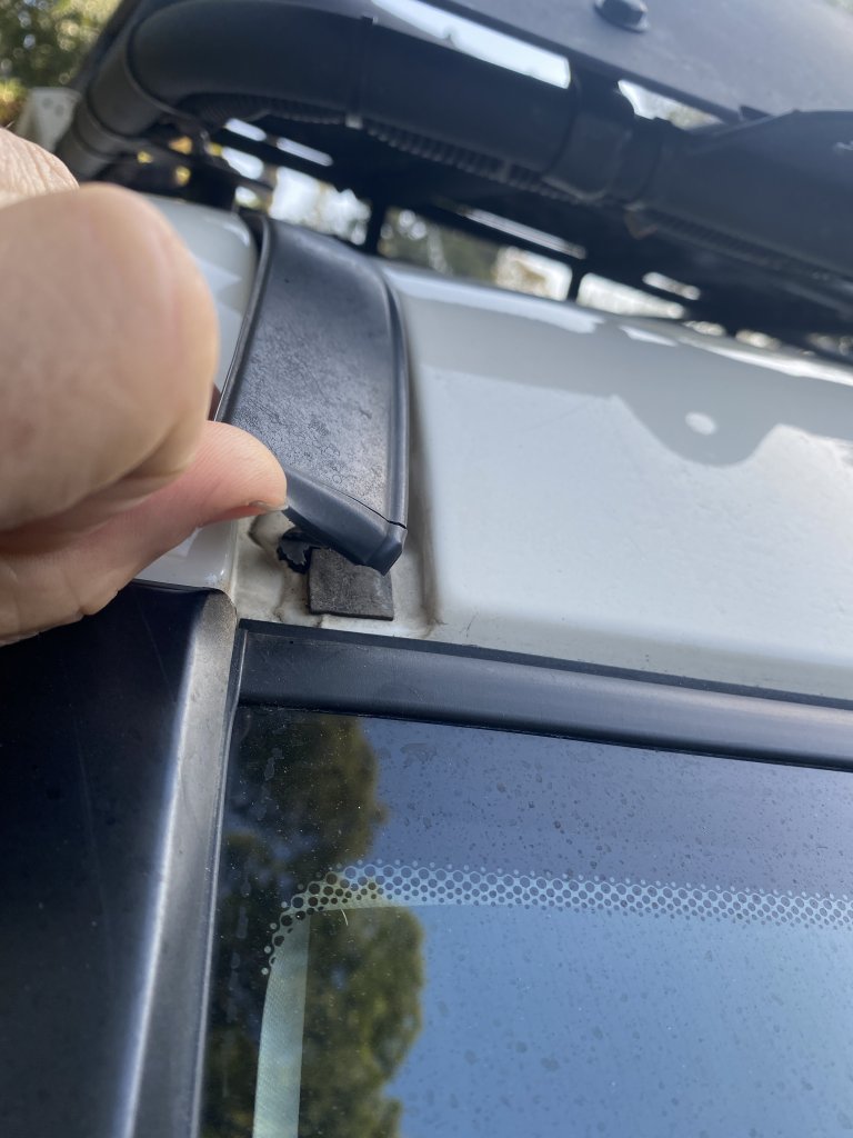

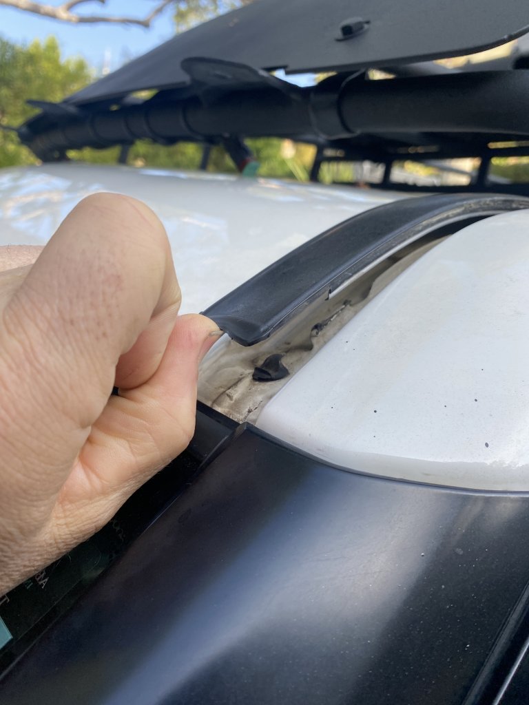

Yes I did used to have a loose Pillar but I replaced it and the clip last year and still lots of noise though, thanks for your input though
Stuart Barnes
Oct 27, 2019
443
238
Los Angeles
Did you use aftermarket clips? There’s a difference when you compare them to the LR ones. The LR clips hold the A trim much tighter, at least that’s the case with mine.

Ok so last week I put some gorilla tape over the seal on the sunroof as we have had torrential rains in LA and the tape has cut the roof rack noise in half !!!! If I get a new sunroof seal do you think it will have a similar effect ?
Stuart Barnes
Oct 27, 2019
443
238
Los Angeles
I’m sure it would help some. After a few years in the socal sun the seal must be a bit crispy.
