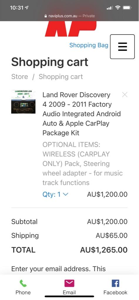

This it??

Yep, that's the one. NaviPlus regularly have discount codes and group buys. I would send them an email ahead of time and see if they currently have any promotions active.
I installed it myself. It's a bit fiddly, but not too difficult. You have to pull the entire center console out to get access to everything you need, but it can be done with standard tools. The trickiest part is unclipping the piece of trim that sits beneath the screen to get access to the screws there. The kit comes with two boxes: one is the main computer/CarPlay unit, and the other is an interface for the Land Rover display. The instructions talk about mounting them behind the screen or behind the main entertainment unit, but I couldn't get them to fit there. I installed them both underneath where the shift knob lives - there's enough room. I would recommend buying a right-angle HDMI cable to connect between both boxes though.
