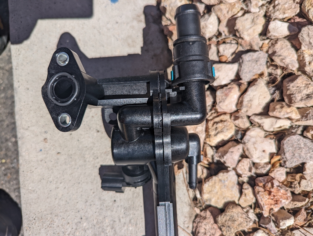

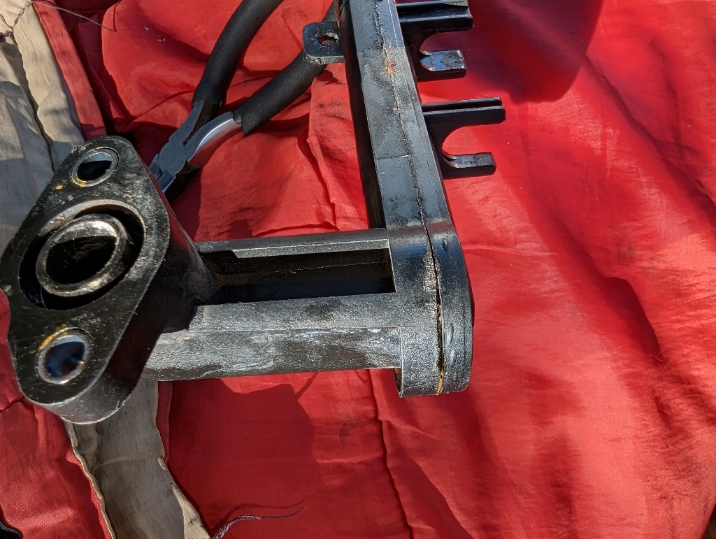

Here is a pic of my old leaking rear pipe. You can see the orange coolant traces coming out between the seams and then a pic of the new pipe where the seams don't look that great

Why would LR give 2 poops about crossovers in a vehicle it last sold 8 years ago? They are not going to put time or effort into addressing it. You are on your own my friend.
