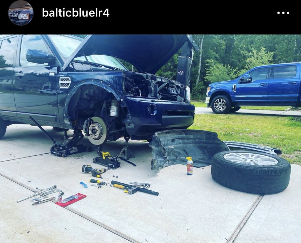

Forgot to post the front air strut swap and distribution block rebuild. Completed both of those in August.
Suncore struts (rebuilt OEM) and Amazon o ring kit for valve block.
Strut job only took 1.5 hours per side. SUPER EZ

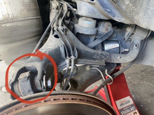

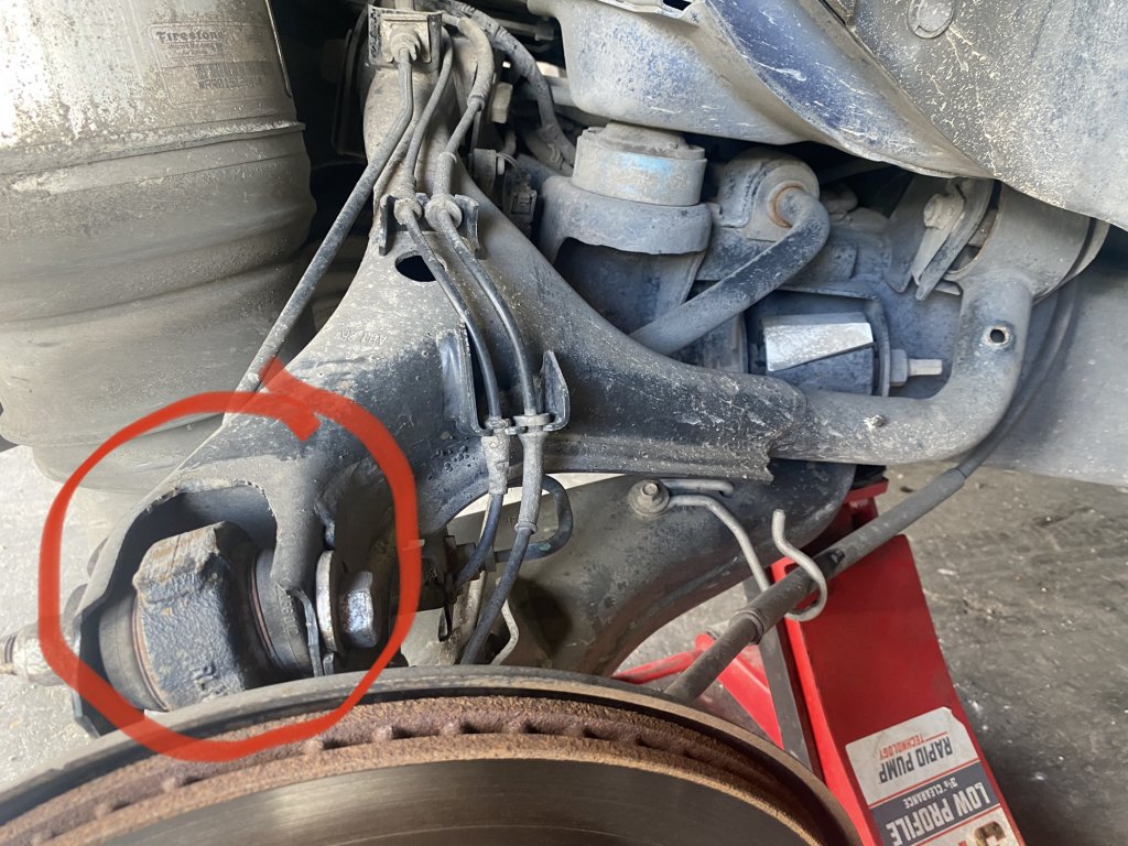

Next up for maintenance is replacing rear knuckle bushings. Have some play in the passenger side.
