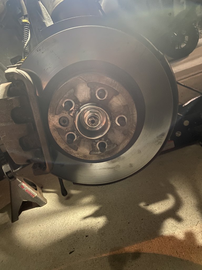

brakes were new but I pulled them all apart, cleaned everything & lunricated the slides

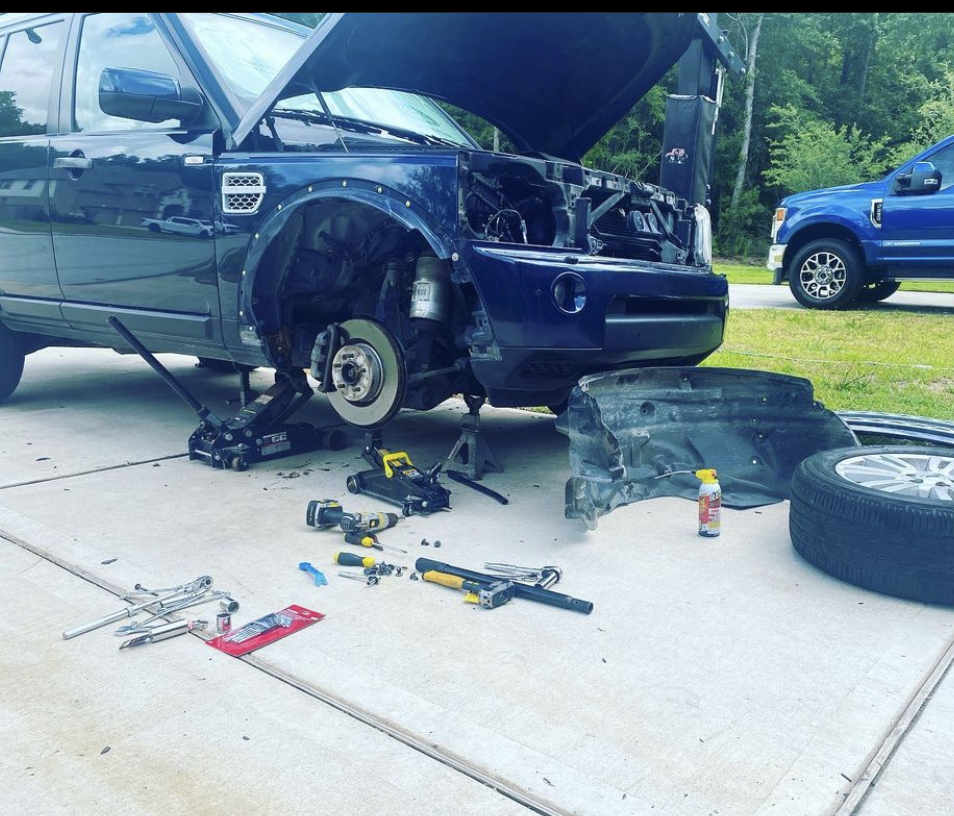

Began the blackout process

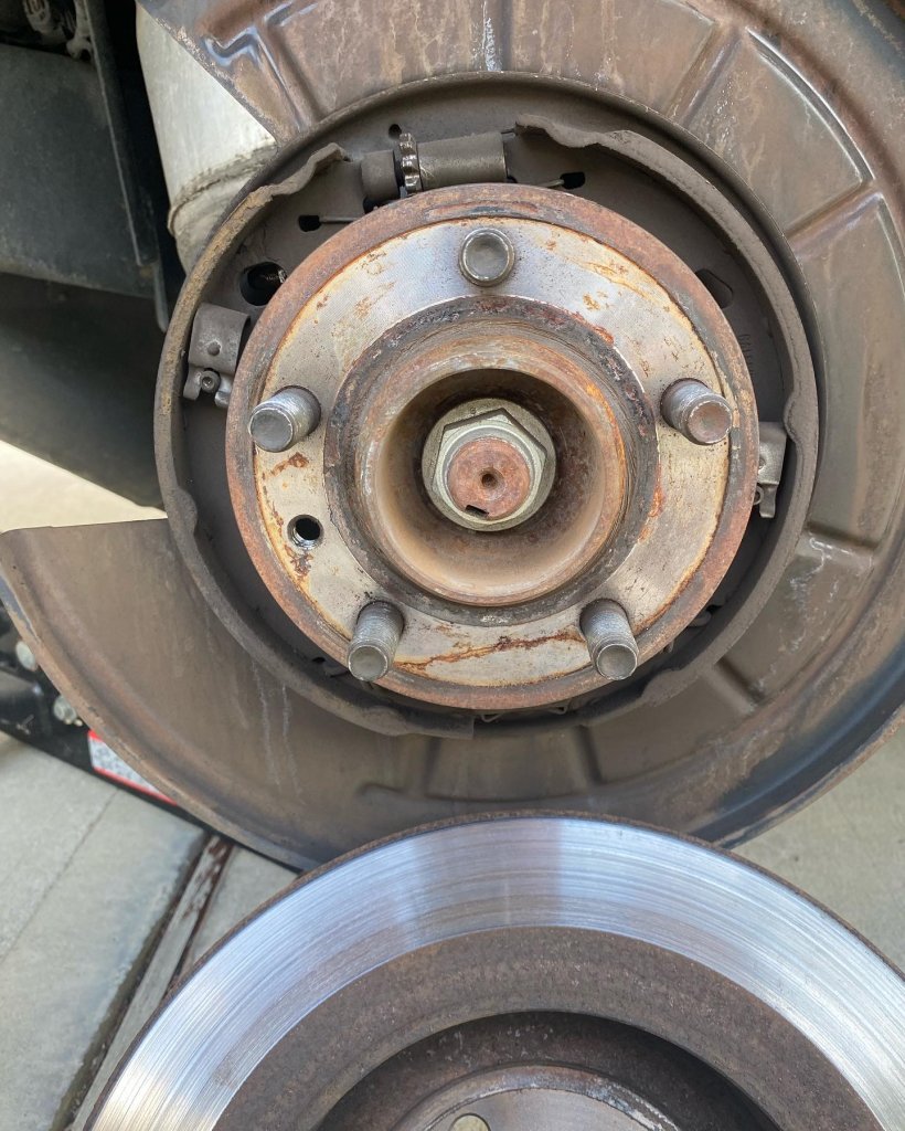

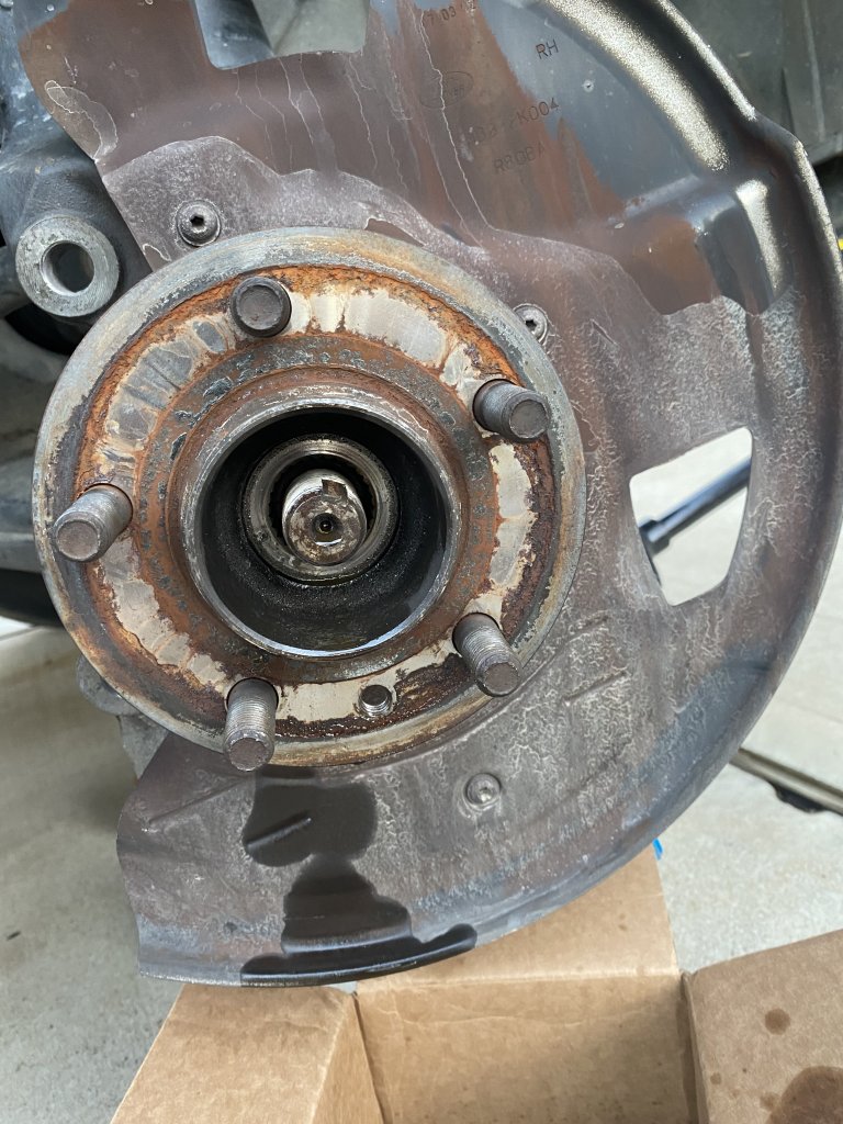

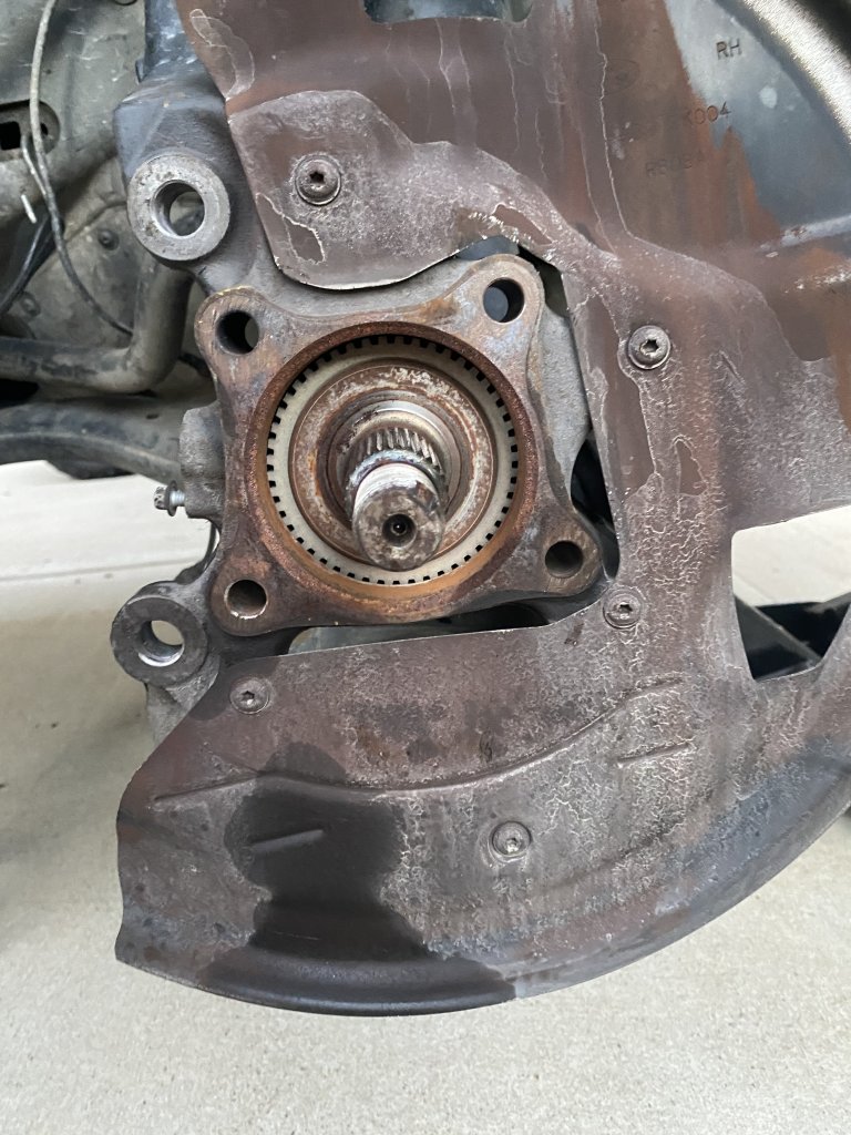

Old front hubs were toast so I spent a few hours yesterday swapping them for new units with NTN bearings.
Not a bad job, only took 2.5 hours per side.
I will say for anyone who comes across this post and is contemplating paying a shop: DIY! No special tools are needed besides the 21mm 12pt socket and BIG axle nut socket.
I needed my trusty impact to remove the axle nut.
Banging on the axle shaft & smacking the tar out of the hub was nerve wracking but oddly therapeutic lol.
Follow Atlantic British’ video posted on YouTube as a process guide.
