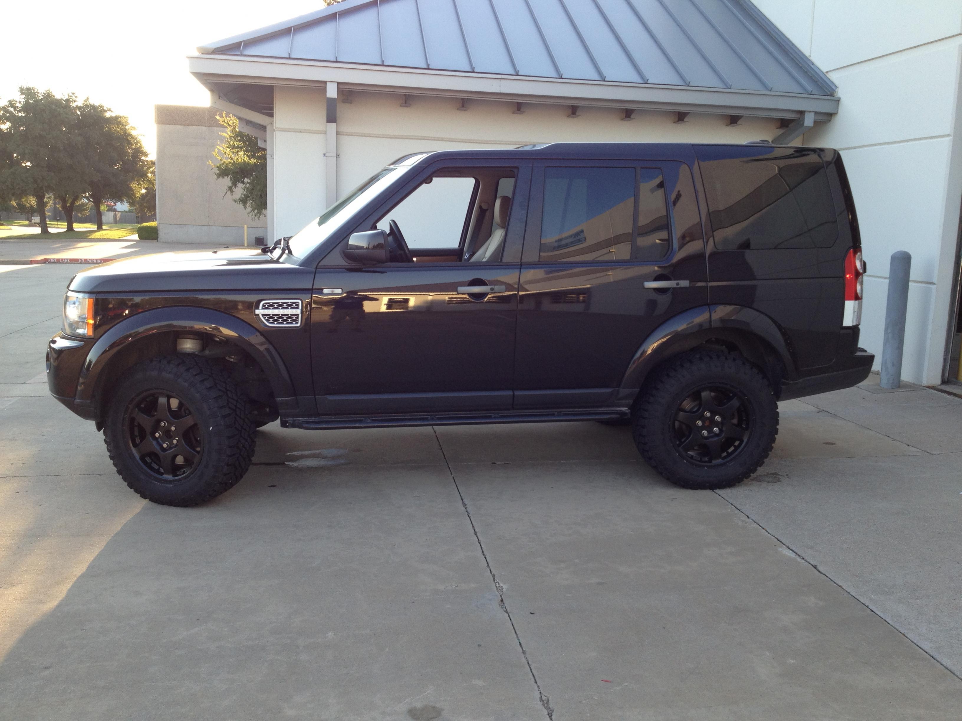

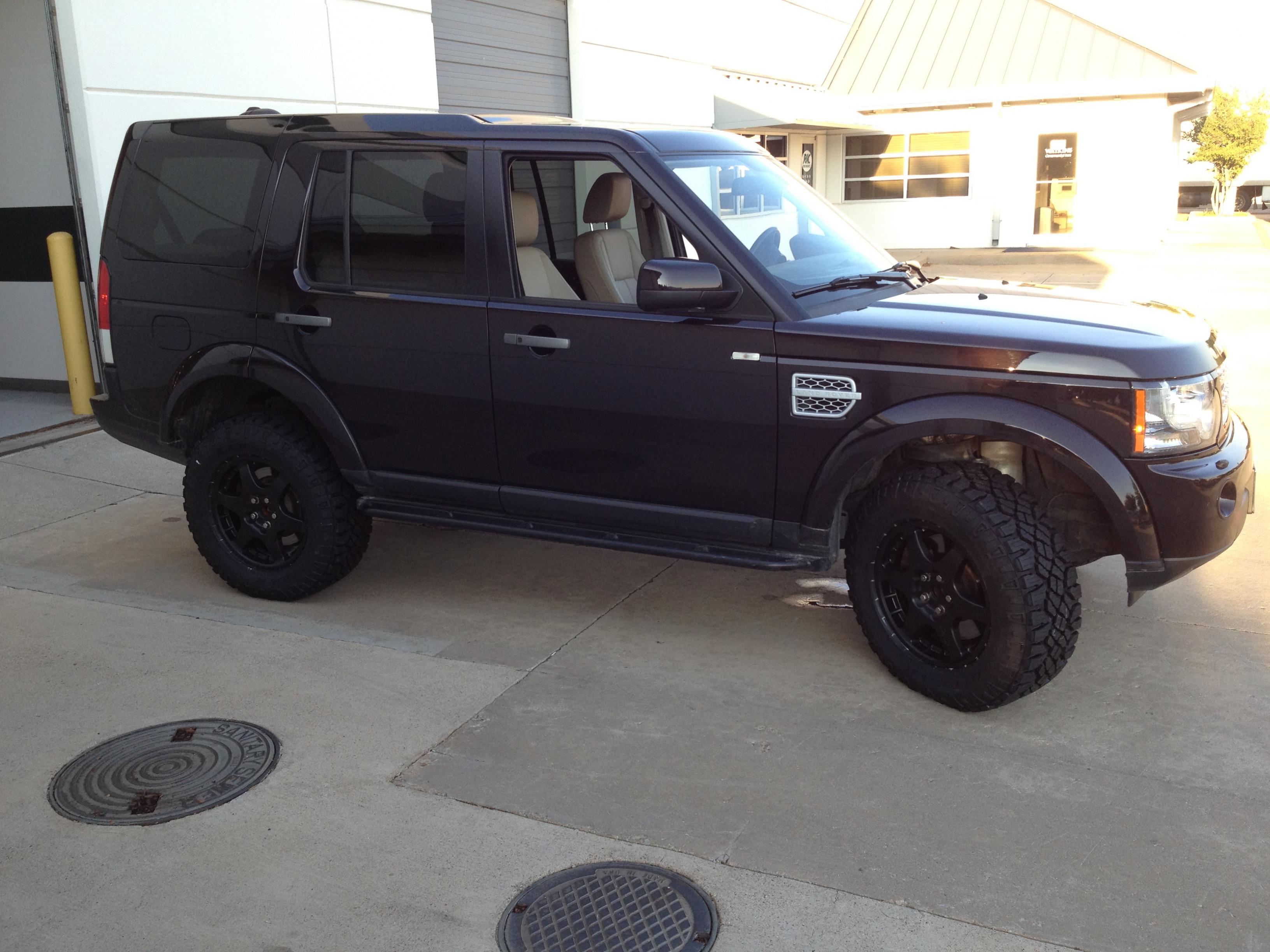

Did the lift with the 275/65/18s!
Love the way it looks.
The rubbing does have me freaked out a little but it is only at tight turns.
I did do the full alignment as recommended in the earlier post. Now I'm just dying to take this off roading... Anyone in the DFW area want to go?

I'm not sure how to answer the question of "how much rubbing".
I put on the 2.5" lift from johnsonrods.com. At normal ride height, which is 2.5" higher than the old normal ride height, there is some when the wheels are turned hard. For me, I have found this to only be when parking and getting out of parking spots. It's not much but it does bother me a little. I thinking about taking it in to a place around me to see if they can push in the bump outs in the front the wheel wells, that is the only spot where there is rubbing and I can't figure out why they have the bump outs there anyway.

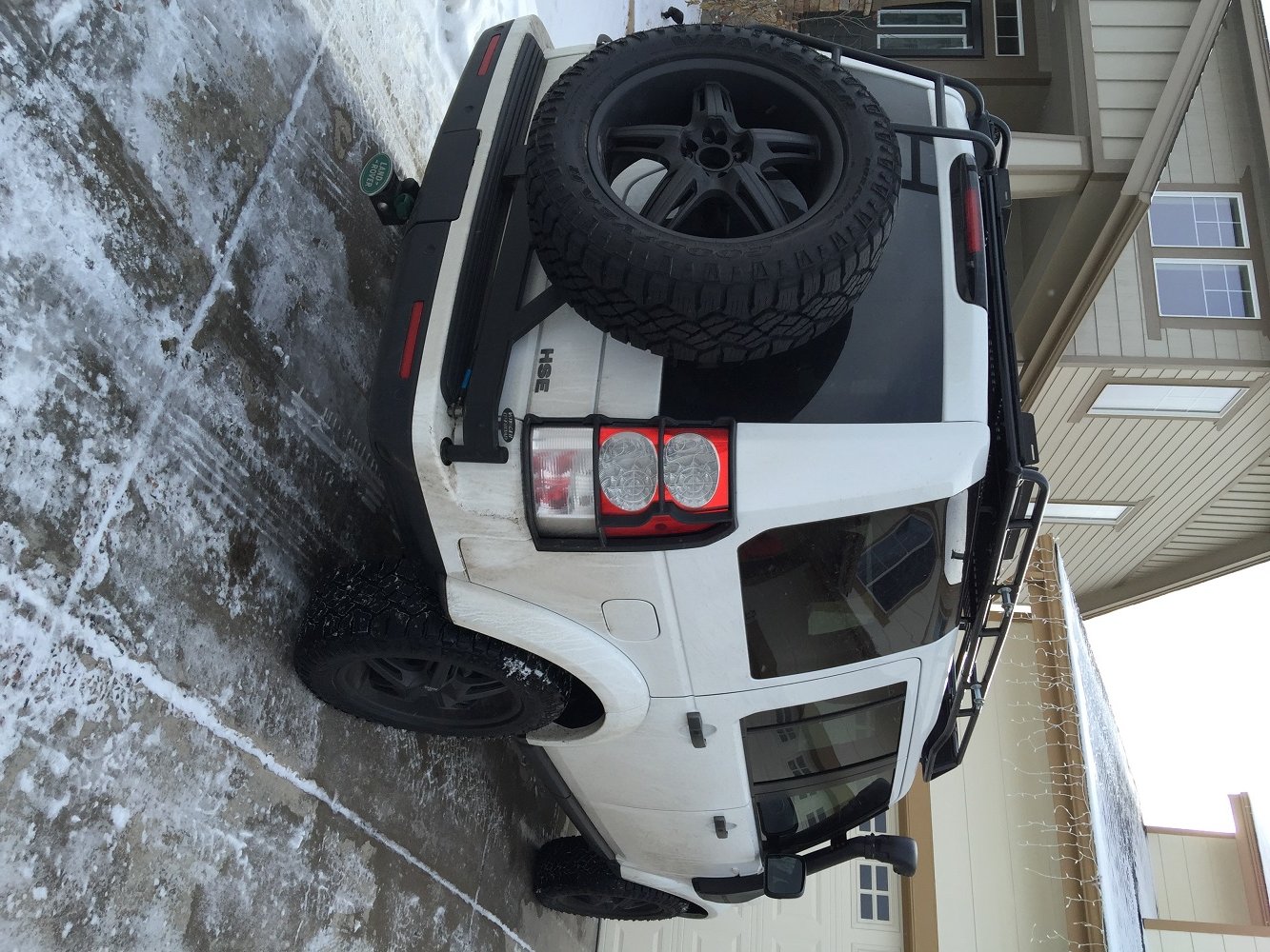

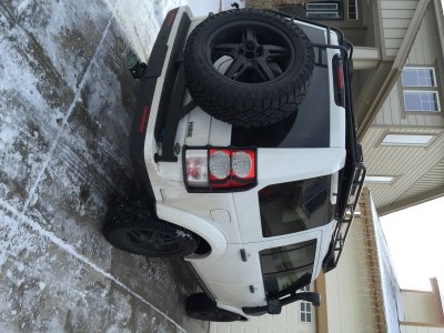

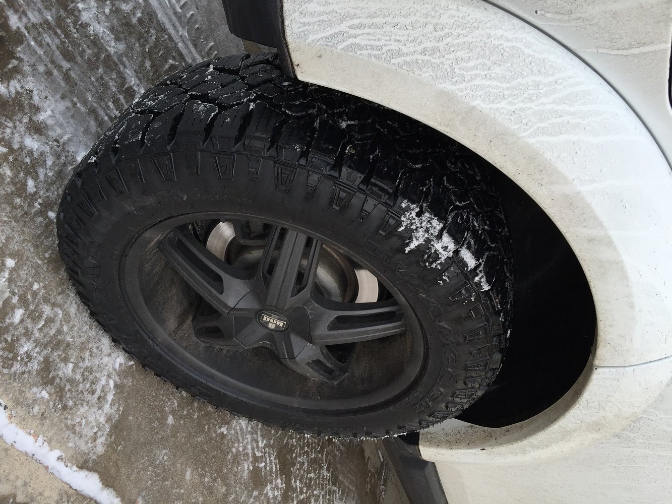

Same wheels still, but different tires. Goodyear released their Duratrac in 275/55/20. More tread and more rubbing, but dealership made some wheel adjustments and the rubbing is non-existent unless I turn sharp to the left.
