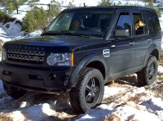

Not the best picture when you have to take it from the drive way, but a better perspective than my previous post.

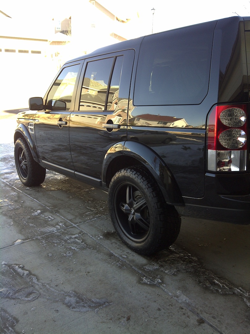

20's at work again.
