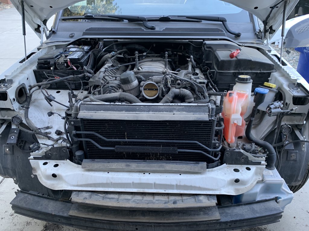

Well I have been super busy. But heres update. Motor is not seized but it does have some friction or a rough spot when turning over with breaker bar. I'm guessing scored pistons. Pulling it out today finally. Then the tear down will begin. Heres a pic where I am at with it. Radiator still has to come out.
