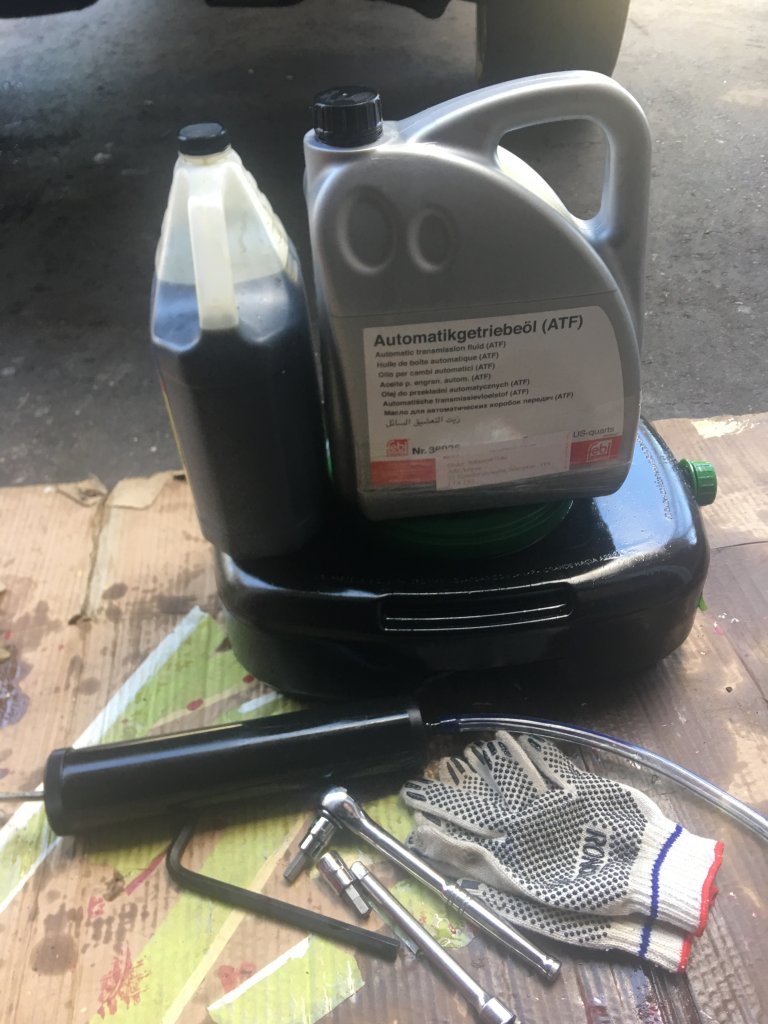

I did my tranny fluid change today, I did a simple drain and refill. 4.25 quarts out 4.25 back in. The most difficult part was trying to put back the fill plug while docking the hot catalytic converter at the same time. By the time i was done i was soaked in tranny fluid, even my lips felt like i just put on some lip gloss. Did a test drive afterwards and the tranny felt like butter.

Azoo:
How many miles do you have on the truck? That fluid looks much darker than mine, but I changed mine at about 62k..
Yeah, takes about a full bottle of shampoo to get that stuff out of your hair!
Mike
222,590
