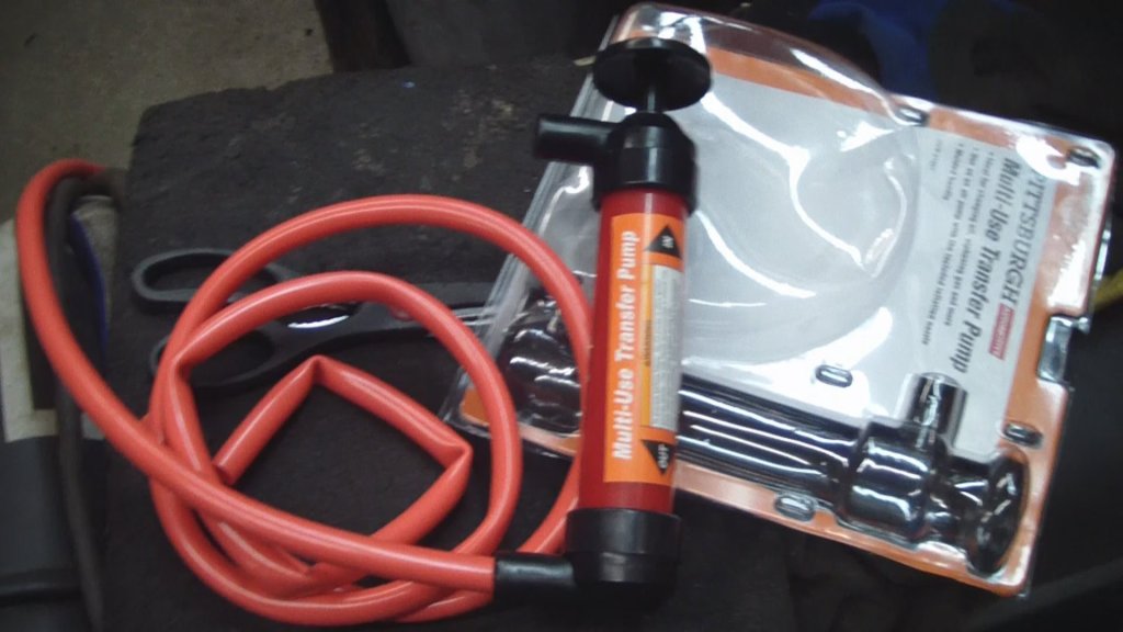

For a pump, I used one from the local parts store, it looks like this:
Try not to buy one that is excessively cheap.. I have bought many in my days, and when the pump starts leaking/falling apart/spraying fluid all over you while your cheek is 3" away from a hot exhaust pipe, your patience will be... tested..
