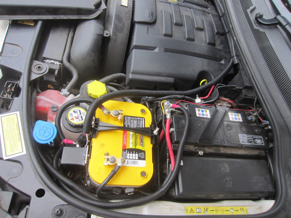

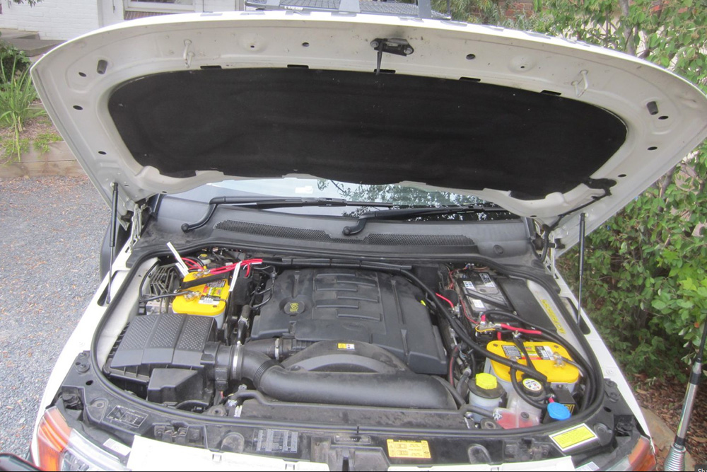

Hi umbertob and you got it in one, Australian LR3/4 and RRS do not come with fuel heaters as standard equipment, which is where the battery tray goes, plus the USA versions have an air intake box in the same location.
Here are a couple of pictures of the Australian set up, some LR3/4 will be similar but you need to check your own LR to see which set up can be fitted.
BTW, the last picture is of a new Triple Battery set up for the Discovery 3 and 4, but again, it can only be installed if you have the area in front of the cranking battery free of an equipment and we make our own stainless steel battery tray to go in this location.
The first picture shows the clear area in front of the cranking battery compartment.
The second shows the auxiliary battery in place in front of the cranking battery.
