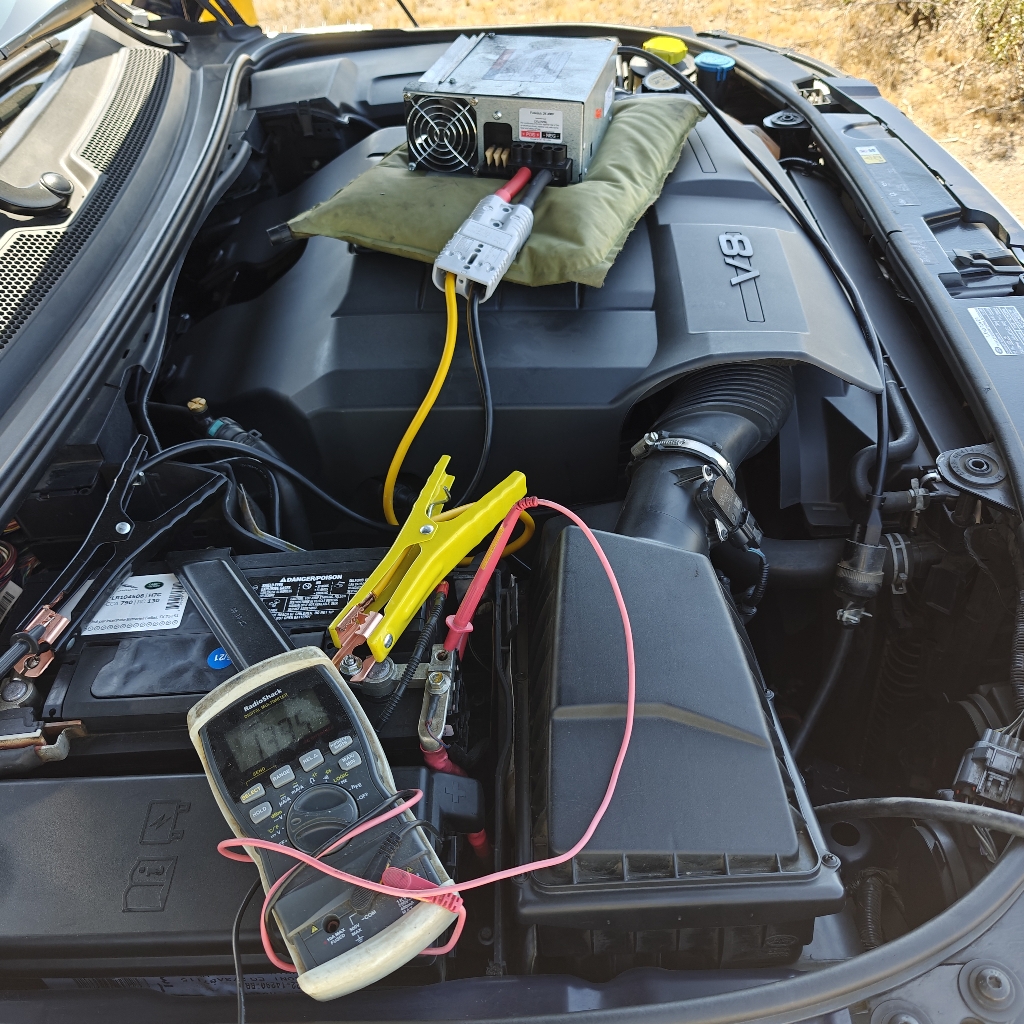

I wasn't aware of an auxiliary battery, not saying it doesn't exist. I just charge my starter battery and keep it topped off. This is how I do it, but with a 60AMP charger:
