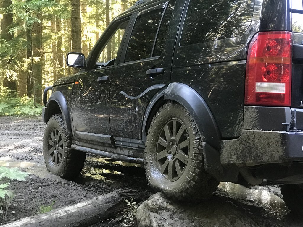

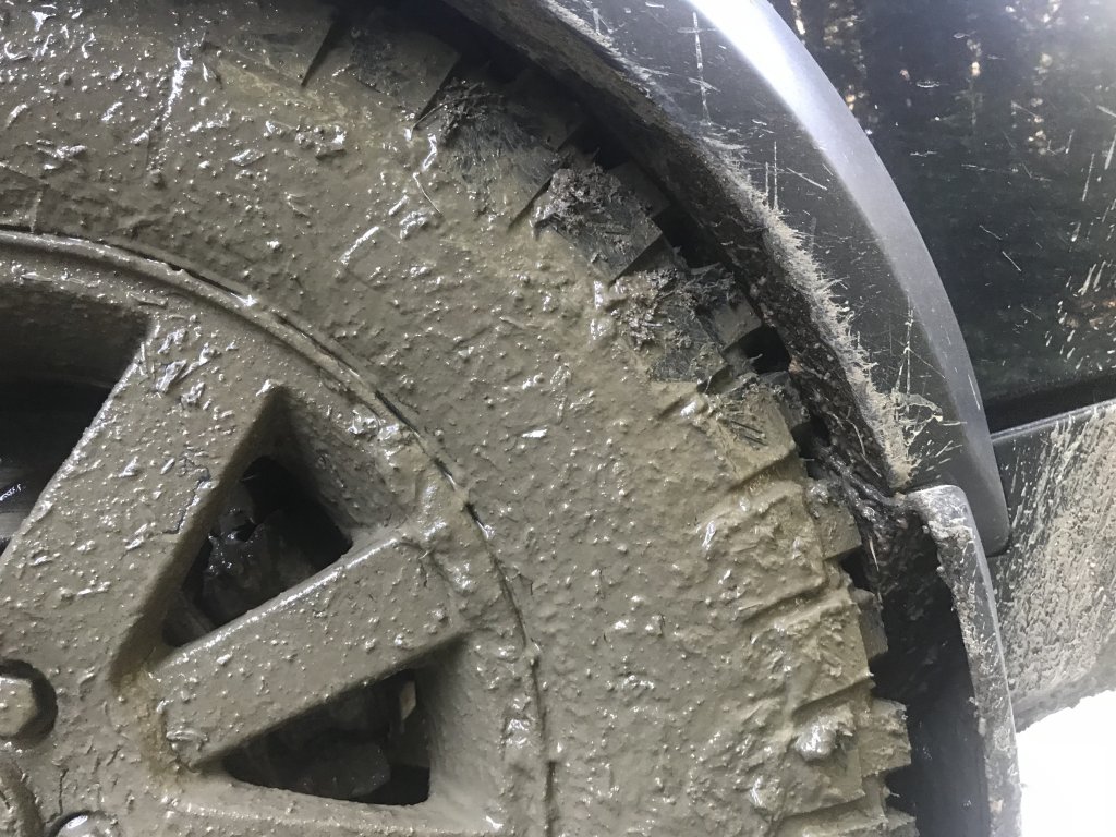

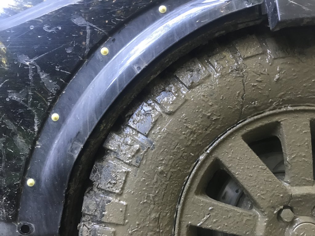

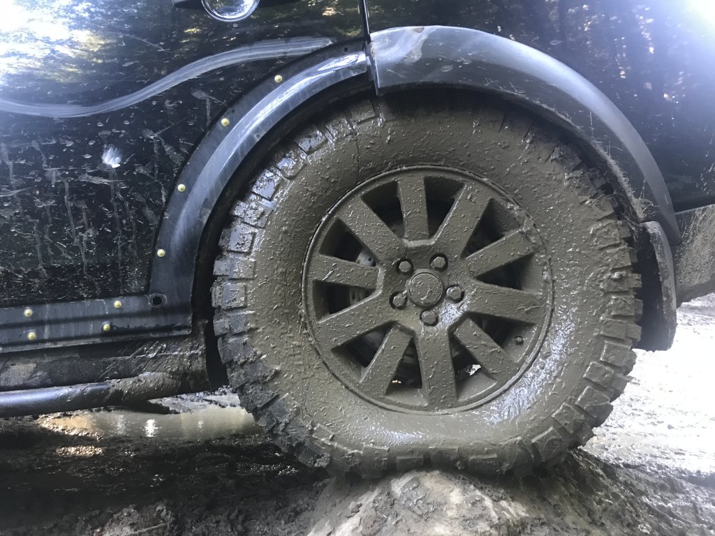

Here’s a BFG km2 285/70-18 on factory wheel. no spacer because they wouldn’t allow the tire to get that high without ripping into the fenders or turn up front without ripping into the bumper.
Shown here isn’t even an extreme flex situation, it gets worse on a real trail.
