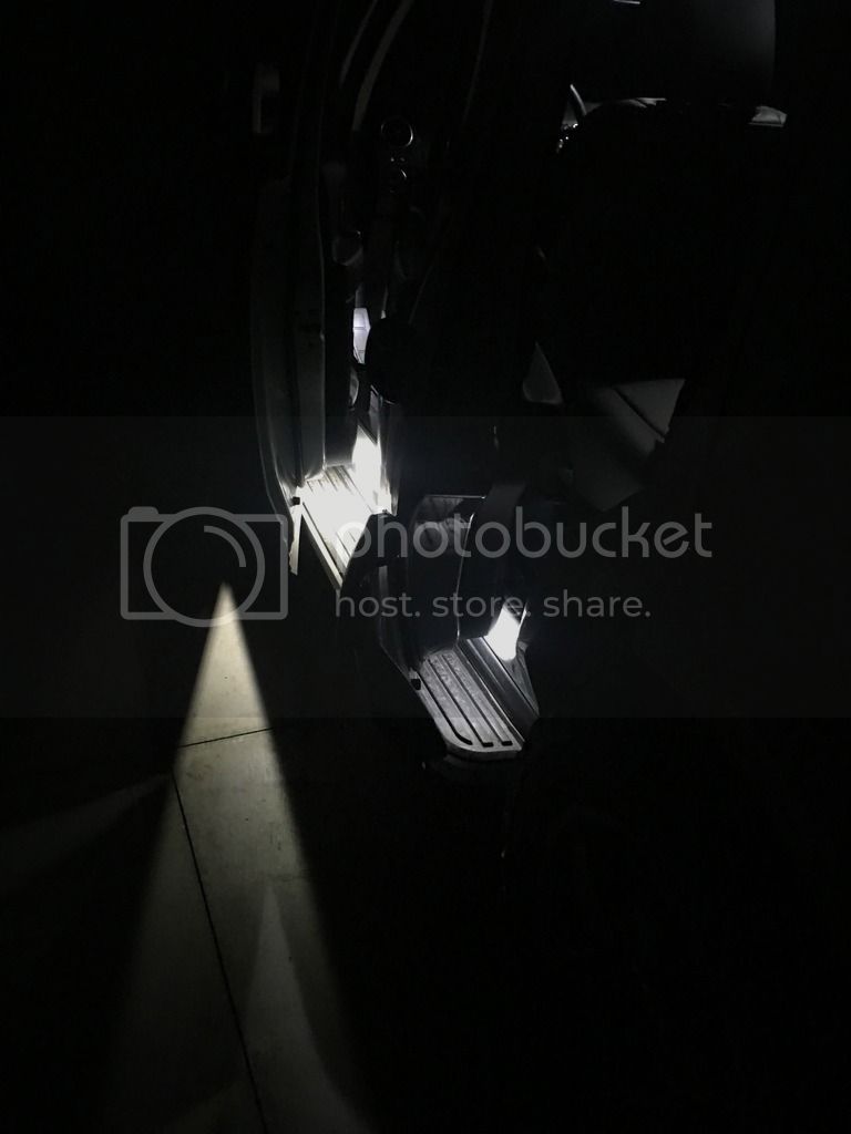

Did my cheapo Yorkim LED (20 for 19.98) install during the day so don't have good before/after pics on those. They were still brighter than the incandescent stock bulbs and feels like a clean white(6500k).
Below pic shows one of those 6500k Yorkim bulbs in the rear door card and the replacement unit in the front. The light projected on the ground tells it all for a brightness comparison. The PowerfulUK unit does seem a bit warmer than the other bulbs maybe 5000k, but still considerably better than stock.
