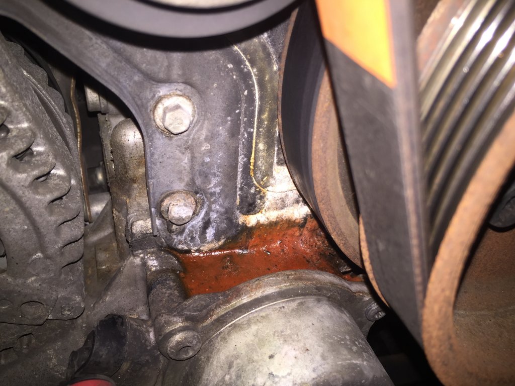

Finally found my leak, at least I’m close. Did it in the dark, with a bright light. Below the pulleys.

Just checked mine on that exact spot and it is bone dry. Also, Coolant level still largely unchanged since Xmas. Not that many miles on it since, but several hundred are still something. I'll continue to keep an eye on it.

I just had this happen to me but the drop in level was not that significant. However, it got one of my indy techs to notice it and explore further and he discovered a leaking water pump. He said it was so subtle that he wouldn't even call it a leak, it was more like a seep. I said that I hadn't seen a drop of any type of fluid under my Rover ever. I then learned that the fluid was drying and congealing on the bottom of the pump before it hit the ground. They told me I had dodged a major bullet. I got the pump and related pipes replaced. My '13 has 47K on it and I don't think the water pump had ever been replaced.

There are a lot of discussions here and elsewhere about how sensitive these particular engines are to coolant leaks and overheating. The water pump and a part of the cooling system called the coolant crossover pipe often need to be replaced somewhere in the 60K-80K miles window. (When I bought my LR4 with 72K miles on it I replaced mine immediately just to prevent issues.)
I don't want to speak for @cperez but my guess is that the "dodged a bullet" comment was that he managed to get it in for service without overheating the engine. A truly overheated engine in these can lead to very expensive repairs (like $15K-$20K in new/replacement engines).

Not to speak for cperez, but generally, a catastrophic coolant loss can overheat and ruin your engine. Given their cost on these vehicles, that could mean a death sentence. So catching a cooling issue without a major overheating event is "dodging a major bullet."
These LR4's are great, but the cooling system is a weakness. Water pump leaks (usually small leaks) and crossover pipe leaks are typically the failure modes.
