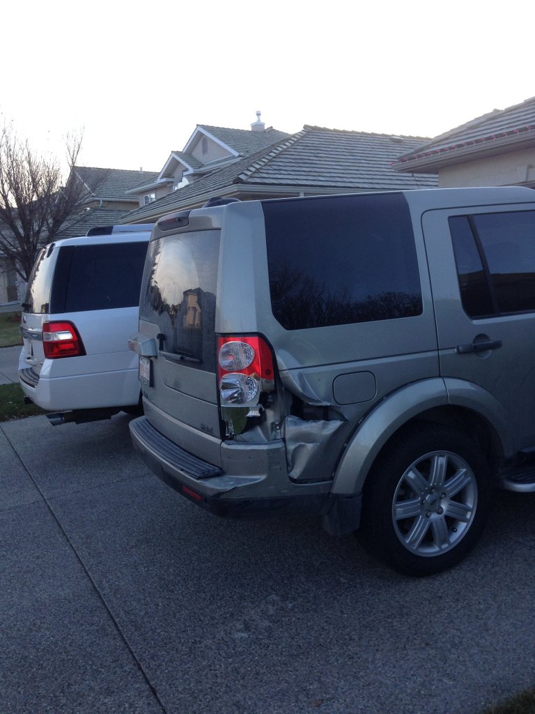

The LR4 got hit last year and was in the auto body for almost 4 months. I was given an Expedition Max (new) to drive for that period and the ride quality was not at the same level (despite the greater wheelbase) of my at the time 7 year old LR4. The Expedition was ok and much better than the Denali (on 20" wheels)but nowhere near the LR. I made the mistake of poly bushings in my first LR3. It was a disaster and ruined the ride, I quickly swapped them for the hydro bushings.
Here is a pic for fun
