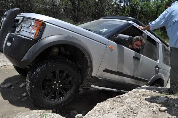

Nice Johnson Rod lift
Tictaktoe
Apr 12, 2015
74
JR,
Get over it! Your sales pitch is quite obvious here, especially after stuffing a picture everytime you post when no one asked for it.
