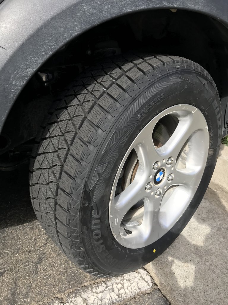

I have BMW X5 Wheels on my 2007 LR3 with 245/60R-18 BRIDGESTONE BLIZZAK DM-V2s. Plenty of fender clearance but I didn't go for an oversized tire. Been running them in the winter since 2010. $275 on the San Jose Craigslist. Strangely I don't have any good picts of the wheels in the snow. They've taken a beating over the years but lot's of "Wow!" comments when people notice the roundel.
