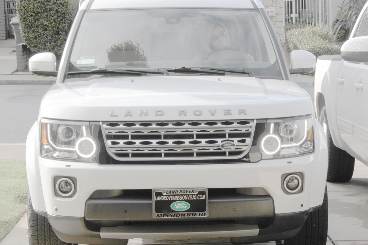

Nice.. I really like the look of that newly redesigned front end on white. Another off topic question, are the bumper cameras the little dots just under the fog lights (can't tell if they are the parking sensors or cameras from your photo), or further down, on the corner of the black portion of the bumper?

Correct, cameras are under the fogs lights. Black dots on corners are the sensors, there are two more sensors to the left and right of the license plate, here's an edited shot.

Thanks for posting a photo - I really like the front in white. You should put black lettering on the front, would look very nice. I guess now even on the standard (non-black) trim, they have some black around the grill. I like it a lot!

I do like the "black look", however there are so many cars in So Cal that have black accents, I can't follow. I'm a tone on tone guy. If I had it my way, all the badges would be removed or painted white. I even considered white compomotives, ended up going.... Wait for this.... Black. Hahah what a hypocrite!!!

HAHAHA! :) WHITE?!? It would certainly look unique.
I think you will love the black wheels. I know there are a lot of cars with black accents, but it just looks different on the LR4 - especially lighter colors like Fuji White.
