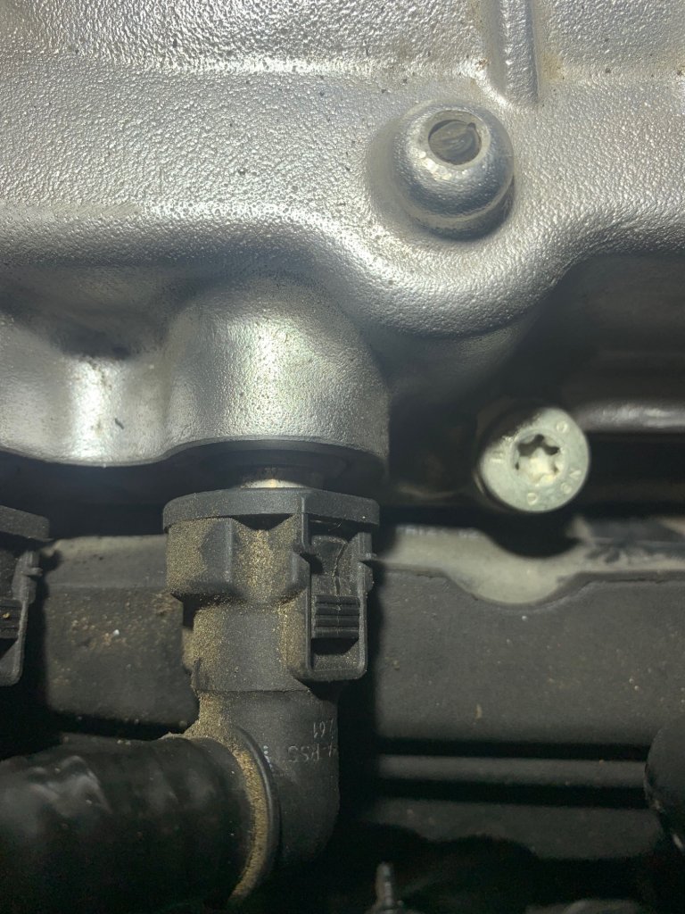

Help identifying 14-16 part (PCV hose) I broke while doing rear crossover.

OK, I am not a newbie, but dang!
How exactly does this come apart??
Intercooler hard plastic coolant pipes, on top, 2 on each side.
Duh...
Thanks!

Just guessing here, but I would expect you push in a bit to take tension off of the retainers, then push in the ridged parts (likely one on the back side too, at 180* from the one you see) to release the retainers, then pull off from the barb.

That’s the correct way to get them off as I recall. I might have cheated with a pliers on a couple - can’t recall. Nothing special though. They are tougher than you’d expect to get off.
