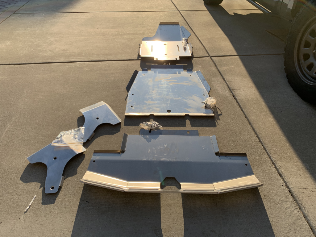

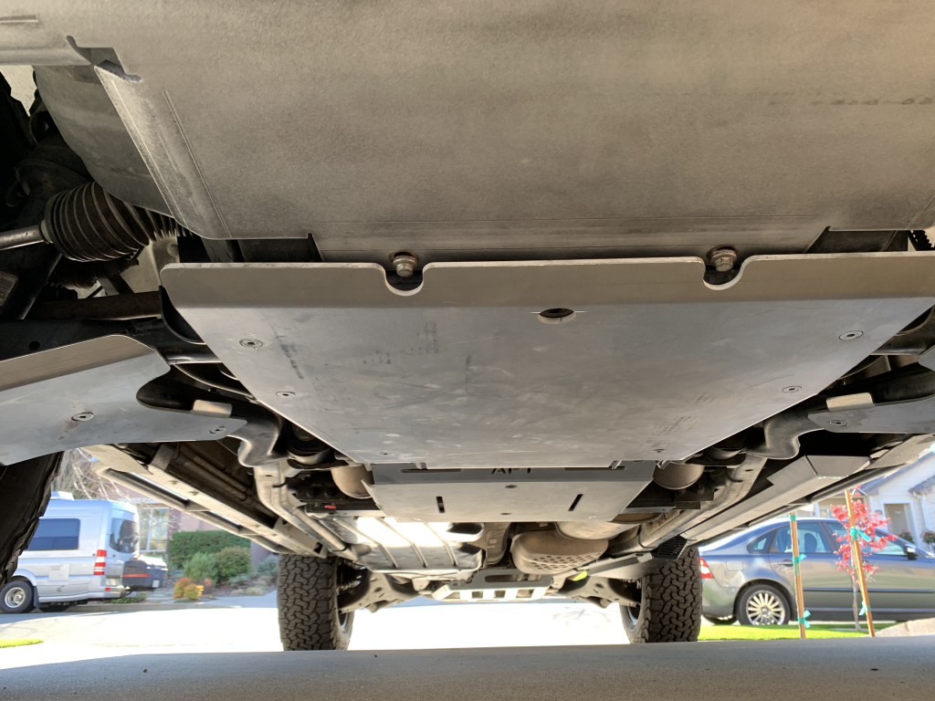

kenk
May 23, 2019
28
17
California
Hey could you elaborate or your fitment of the APT trans plate? I have Bens compressor and tank skid but went to confirm trans fitment with the V8. He replied that the trans plate does not fit with the NA V8 and that modification would be needed and it’s not bolt on because it’s designed around their diesels in Oz
Got to a computer so able to upload some pics.
