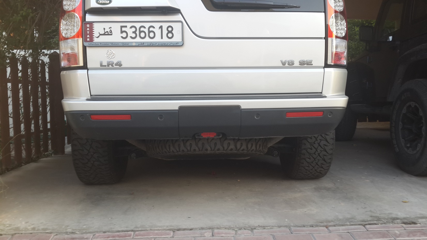

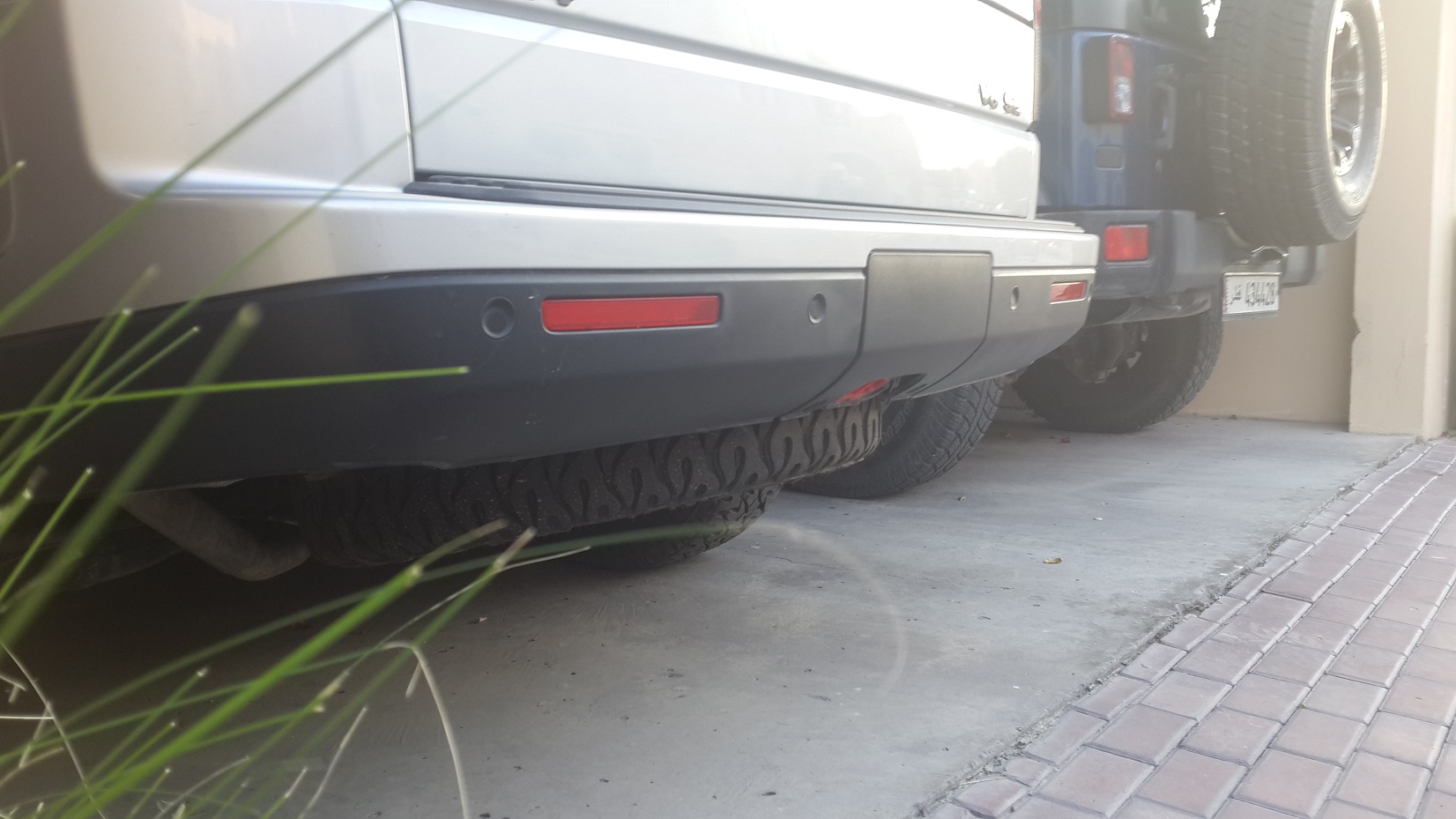

Here are a couple pics of my Spare fitted underneath. It is definitely hoisted up to the top (sidewall touching the metal). What do you guys think?
TLB
Feb 11, 2011
290
21
It looks good to me. How much did you have to deflate the spare to fit it?
Surfrider77
May 17, 2013
900
127
10 psi.
I only ask because others' pics in this thread doesnt seem to hang below the bumper as much. I can only guess its because mine are 285/60 vs their 265/65 width difference.
