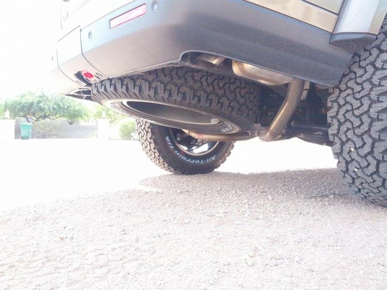

I have compomotive wheels with BFG TA KO 265/65/18.
No problem with fitting spare wheel under the truck.
After removing heat shield and deflating a tire to 8 PSI everything works just fine.
It takes maybe 5 more minutes that placing full size spare under the car. It takes 2 extra minutes to get it out.
I use the same method Umberto mentioned. I have to use my feet to kick the tire slightly so it moves all the way behind hitch adapter and then crank it all the way up.
I tried my hitch receiver in and out with a spare in place and no problem with it at all.
I remove the spare tire from under the car when off roading and place it in my cargo area. I am not concerned about departure angle or damage to the spare. Umbertob is right - the spare is actually good to protect the car from damage. The only reason I move the spare into the trunk is an easy access to it in case I had a flat tire. Even removing a donut or full size spare in the wilderness could be problematic. Just try to get your spare tire out from under a car and put it back. Not just lowering it and cranking up but actually getting it completely out and then placing back . After doing this exercise in my driveway I decide to keep my spare in the trunk.
I move the spare wheel back under the car for day to day driving.

Hi David,
You really have to deflate the spare in order to fit it under. My first attempt was a failure because the tire was "overinflated" :wink: ( 15 PSI).
After getting it to 8 PSI everything was OK.
