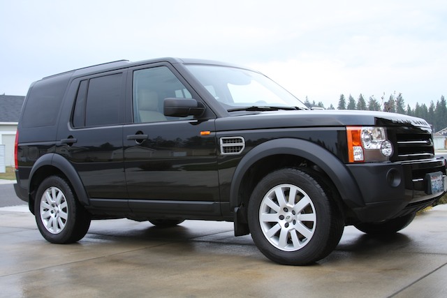

I included a picture of her first wash with me.... a fresh bucket wash and griots rubber cleaner on the plastic trim.... then used the griots spray on wax... and finished with the griots vinyl & rubber dressing on the trim... Cleaned up nicely... cant wait for next sprint to remove all the swirl marks! O btw I am a bit OCD....

Your rover looks brand new. Good job cleaning it up.
