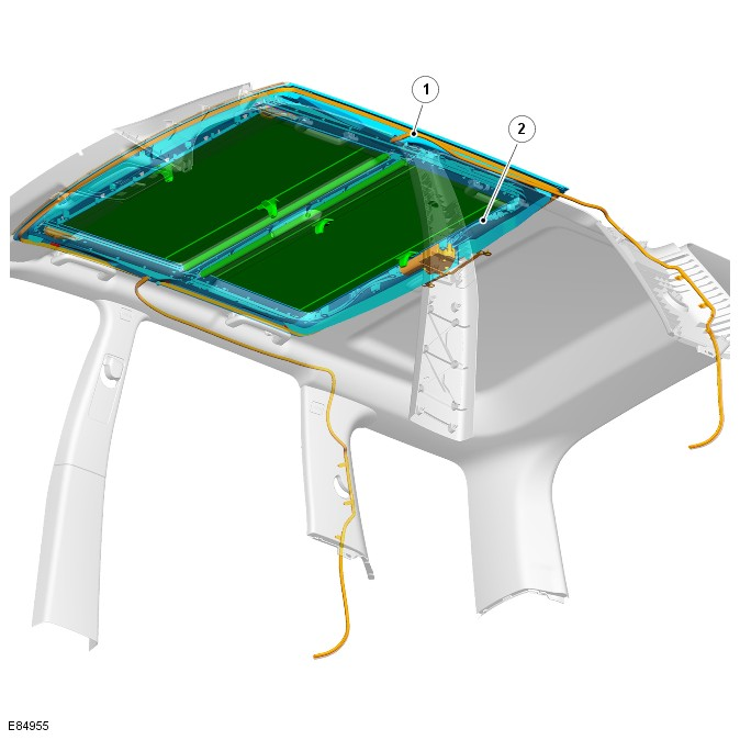

I read all the forums on this; however I cant find either the drain hole or the Lr2 outlets. The outlet must be in a different place than the LR3 or LR4 because it is not behind side fender grills.
I have water getting into the passenger side A Pillar and leaking into the floor area. The local Land Rover dealer wants $1,400 plus to remove dash and fix. That seems excessive as I have seen videos on LR3 & LR4 and it looks like a pretty simple job to clean line.
I Recently bought this car from a person who parked it outside under a tree that drops leaves/debris year round. I had the vehicle detailed and it looks great. This leak is the final thing that needs addressed.
Any help would be appreciated. Esp. picture of where the drain opening begins and ends.

Sun roof drains are in the "C" pillar, exits into the rear wheel well area.
