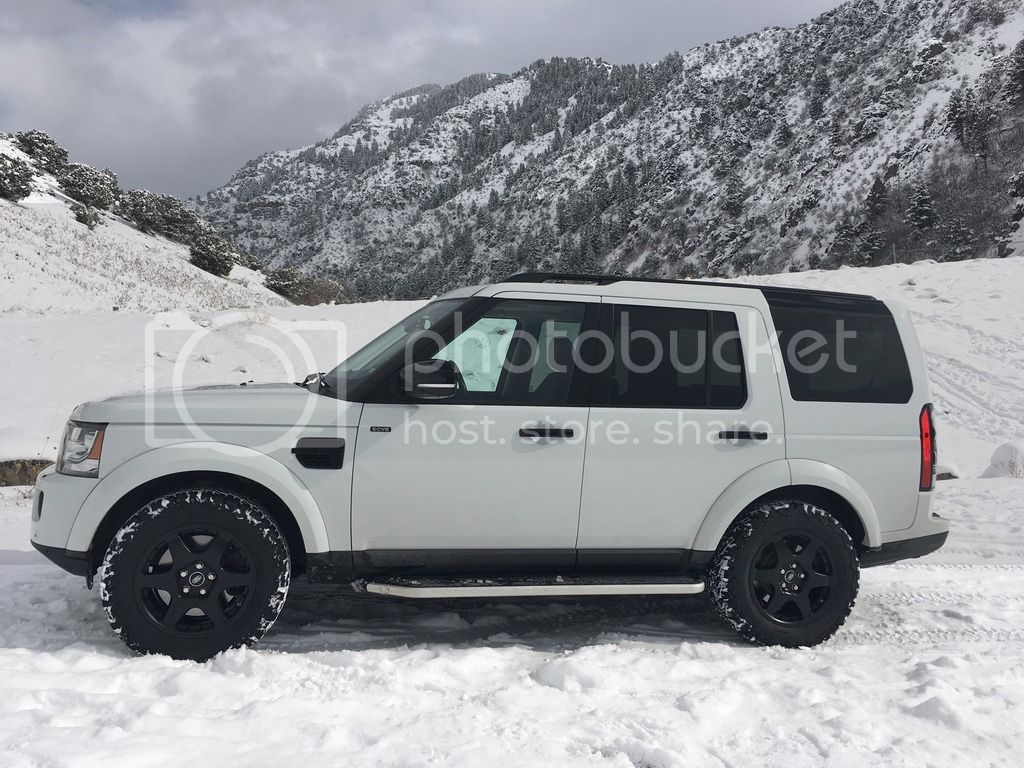

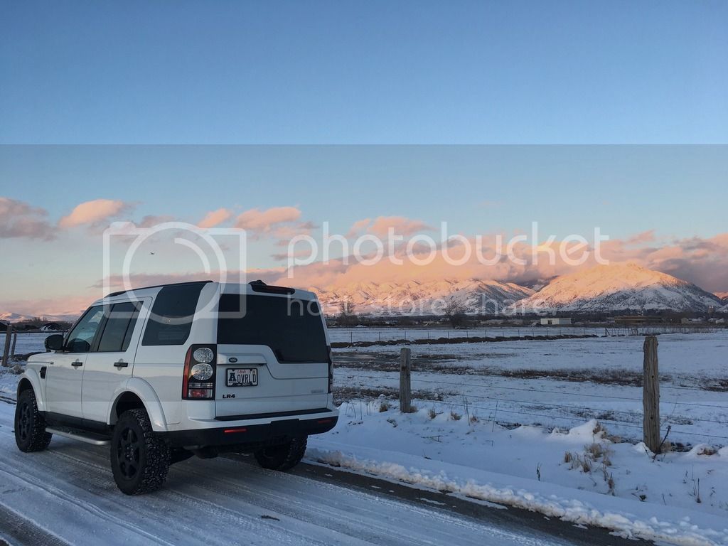

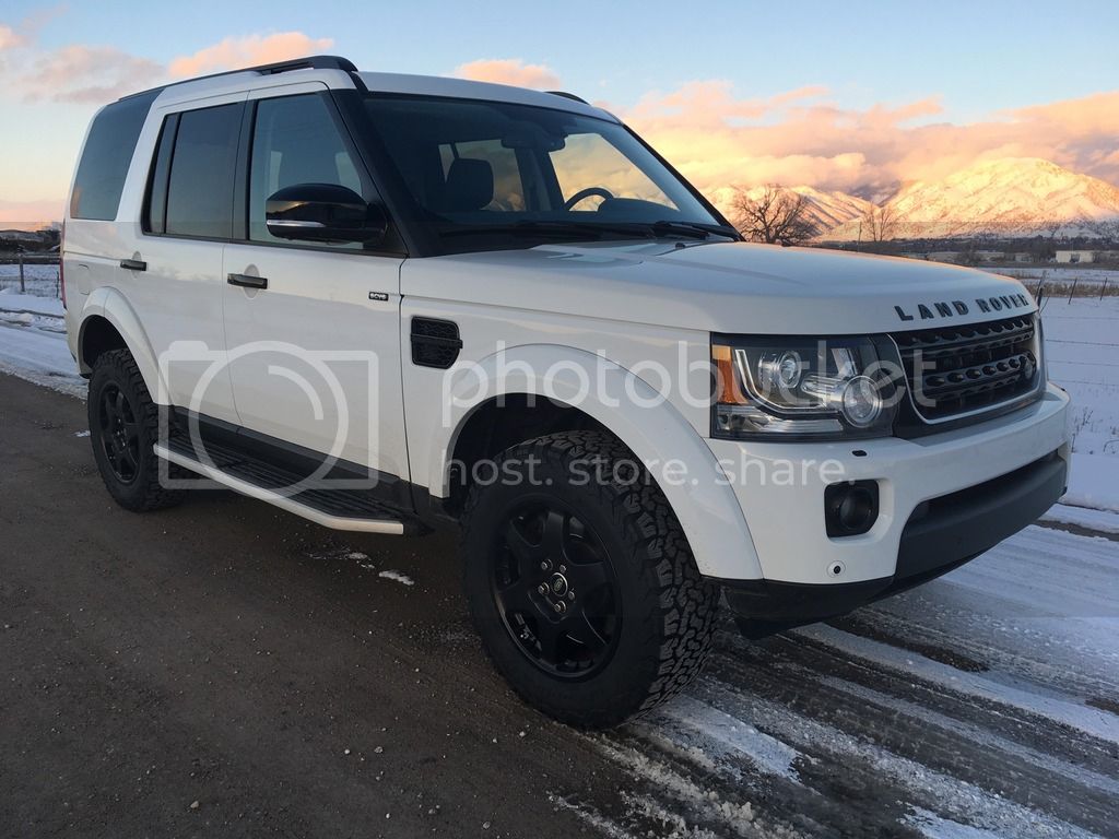

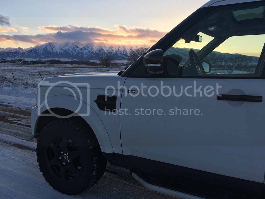

I've had my LR4 about 2 months now and am loving it.
I ended up getting Compomotives and KO2s a little quicker than I anticipated so I could be sure to test them in snow this season.
Greg @Johnson Rods provided excellent personal service and care with quick shipping on the wheels.
Now I just have to take her on some real trails...
Couple of quick pics from this weekend:
