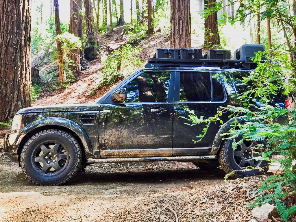

Heres some pics of black rims on a black body from P_J_F earlier on in this thread - these happen to be BFG AT 265/65
http://www.landroverworld.org/threa...-lr3-with-18-wheels.24788/page-35#post-157830
Dang. Those look pretty grey...
That is the one thing I am worried about with these wheels. My white LR with the black pack is a good look and I'm worried the satin black won't quite be as dark as the rest of the black bits.

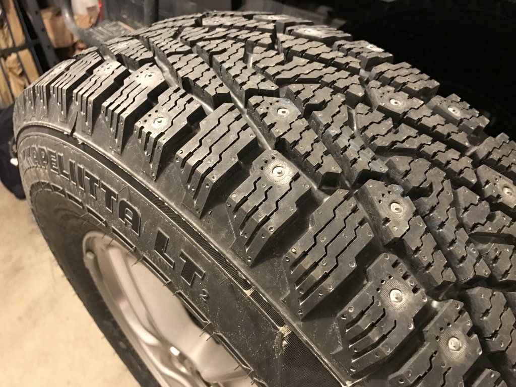

Best winter traction available on LR3/4 aside from actual chains.
Nokian studded LT2 E load range 245/75-17 but also available in 275/65-18 with less bite due to added width. The 7" wide tire cuts better through slush and has higher ground pressure.
It's been truly astounding so far in a worse than normal PNW winter ranging from 0F hardpack ice to deep wet snow/slush.
