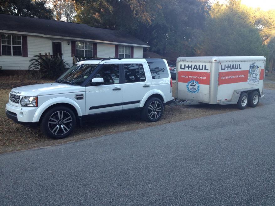

Anyone have rear end picture of 285s installed?
Planning same rims as my previous '11 pictured below.
