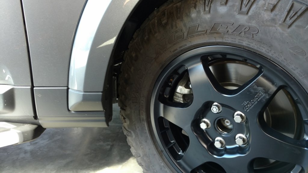

First off, new wheels and tires

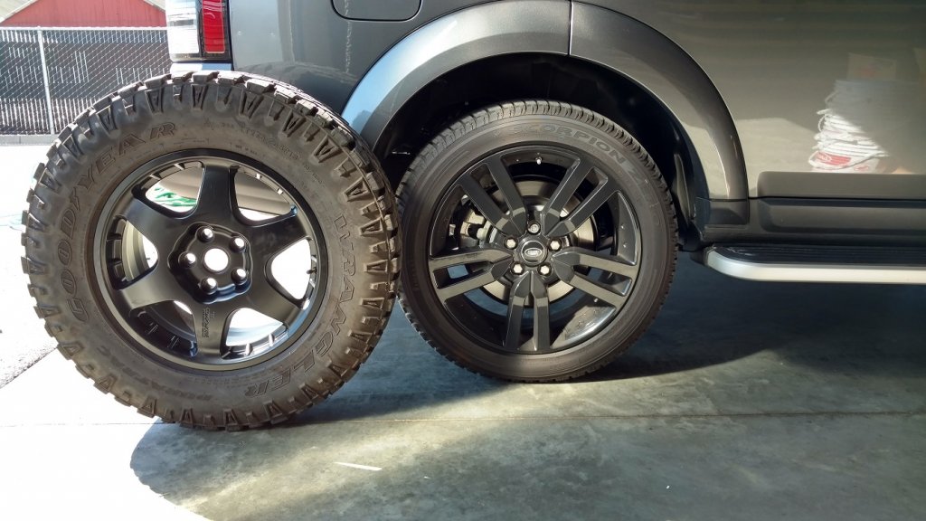

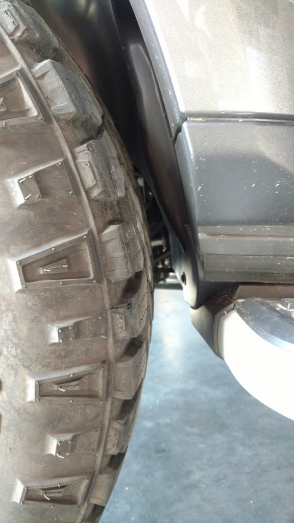

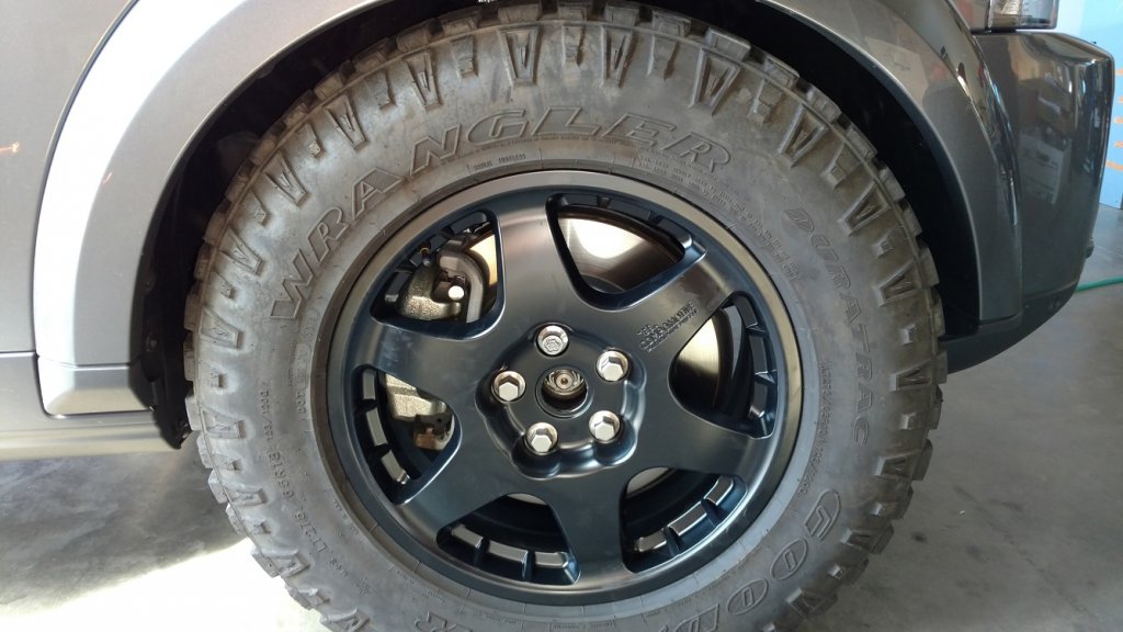

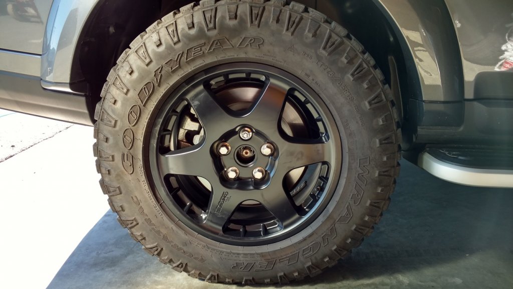

I had a moment earlier today to check fitment with one of my Compomotive 18 inch wheels. I borrowed a spare Duratrac 275/65R18 from my LR3 collection. The tire has roughly 8,000 miles on it and measures 31" diameter. Fitment was without Johnson Rods (still in package). Rear tire, slight rub at front along plastic fender liner. Front tire, slight rub at frame horn and front fender trim when full lock (don't have this problem with my LR3 using Sasquatch Rods). With my LR3 I had to relocate the heater lines at right rear fender well and trim body joint at both rear fender wells. May have to do this with my LR4...

wow.. the wheel looks huge in comparison to stock.

Yeah, that 275/65/18 is technically a 32.1" tire, not a 31" tire. With 0.56" of tread it would technically have to be bald to be 31". I think there are variances between tires of the "same size" as some have mentioned more rubbing than others when using 285/60/18 or 265/65/18. But I think the differences would be fairly small, like 0.1" or 0.2" at most and any minor rubbing issues would be mostly when new (at max tread).

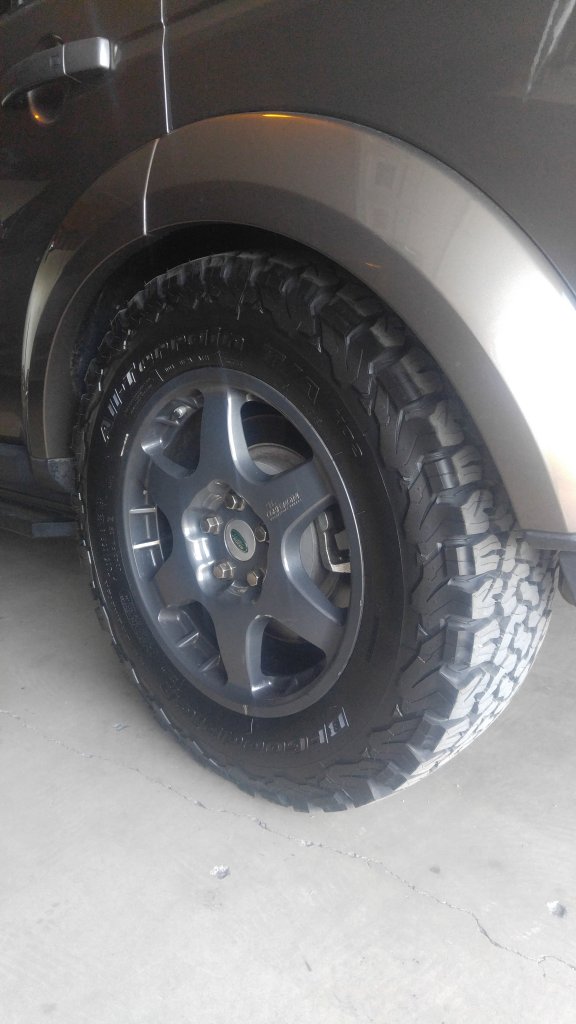

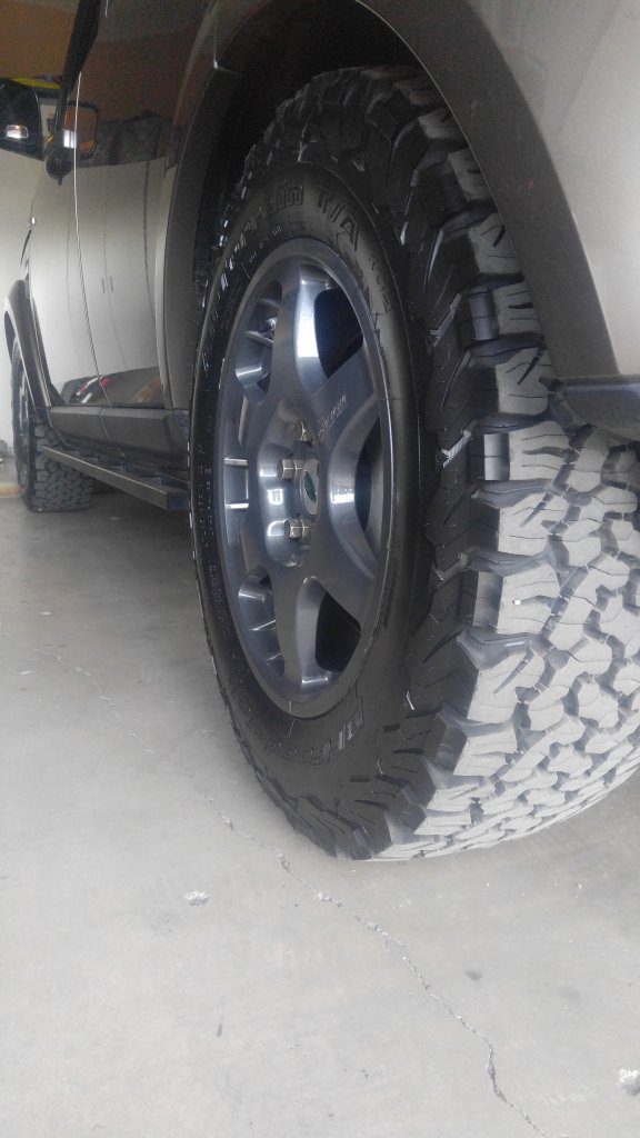

Installed BFG TA KO2 ( 265/65/18). No more vibration. The ride is smooth, and very quiet. I was able to use my DiscountTire "warranty certificate" for two tires so ended up paying for three.
As for now I set up front to 47PSI and rear to 55PSI. If this will feel too stiff I will deflate 2 PSI. TA KO2s look amazing. Looking at sidewall tread design it should be more durable then the 1st generation. I did not have a chance to try them off road yet.
