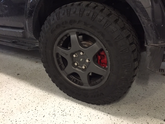

P_J_F, What made you decide on the 265/65s? I've had enough time to think about my configuration with the help from this thread and Umberto; i was certain on my decision 285/60s on compo 18s. But since checking back-in and reading recent posts....dam!...I'm not so sure so thank you all! Lol. Would love some help re-deciding as I need to order the tires as my compos will be delivered within the next week or two.Tomorrow I will finally be mounting my new 18" Compomotive's with some 265/65R18 BF Goodrich A/T KO2's.
I've had the Compo 18"s sitting in the garage staring at me everyday while waiting for the new KO2's to come out!
Anyone running 265/65R18 BF Goodrich A/T KO's, what PSI are you running? Or anyone with a comparable 10 ply / E load tire what PSI would you recommend?
Also - I know I'm going to have to air down my spare pretty low to try and fit it in, is it going to throw a TPMS error?
Thanks guys!

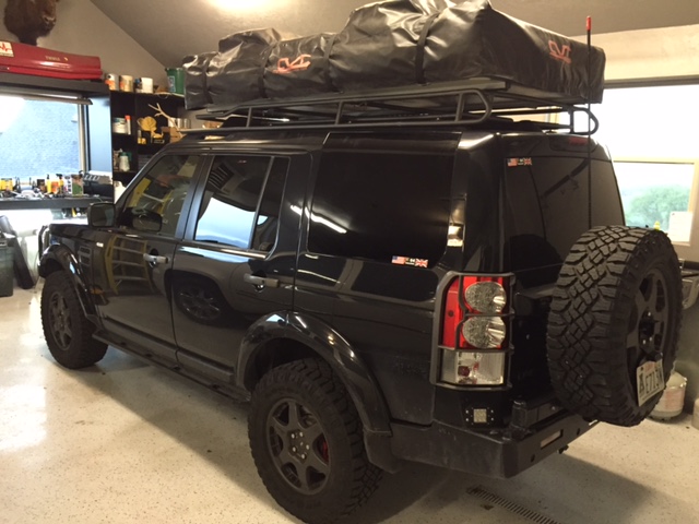

I put about 15,000 miles on my BFG TA KO 265/65R18.( highway, city and regular off road driving) I do 5 tire rotation pattern. So far so good. On the street I run 42 PSI front and 48 back ( cold tire pressure). When off roading I air down to 30-35 PSI ( hot tire pressure) for better comfort. It works for me.
Live in the north east so factor in about 4 months of cold rain and snow. Wheeling in Rausch Creek, PA has mud, mud and oh... More mud. Sharp as heck rock, wet brush etc... I haven't found other places to wheel beside Rausch but figure any place in the north east will be the same. It is also my everyday vehicle. I camp when I go wheeling typically with family, all 5 which means I have heavy load on top. I thought a wider tire would be good for snow, mud etc... I also like the look. .
My LR4 has just about every off road modification I can think of done to it.
I also have Johnson Rods on full time. All of these makes the LR4 feel very spongy on the highway. My kids seem to get car sick easy in my LR4 when I am on windy roads. Also pulling a trailer on the freeway is a little scary now.
If I am being honest the only reason I run the Rods full time is because I like the looks of the LR4 at the off road height. And the extra 1/2 lift more than the GAP tool is nice also. The inside fenders have been trimmed enough that on the streets I used to run in stock height even with the 275/65R18's. And then off road I would use the gap tool to lift it. If I didn't have to change the alignment I would for sure only use the GAP Tool and run it around town with the 2 inch lift then for road trips lower it to stock height because it performs better at highway speeds when its at stock height.
The previous owner put the Kaymar bumper on re-welded and moved the spare tire carrier to the drivers side so you get the full view out the drop on the passenger side of the rear window. .... Opening the spare tire carrier latch bothers my wife when she wants to load grocery's and such in the back.
Then also put a normal spare tire under it again so I can limp to a tire store if I got a flat tire.
