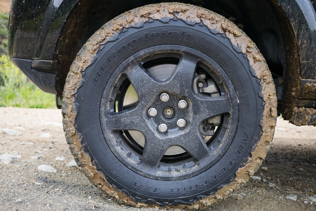

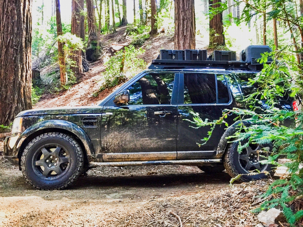

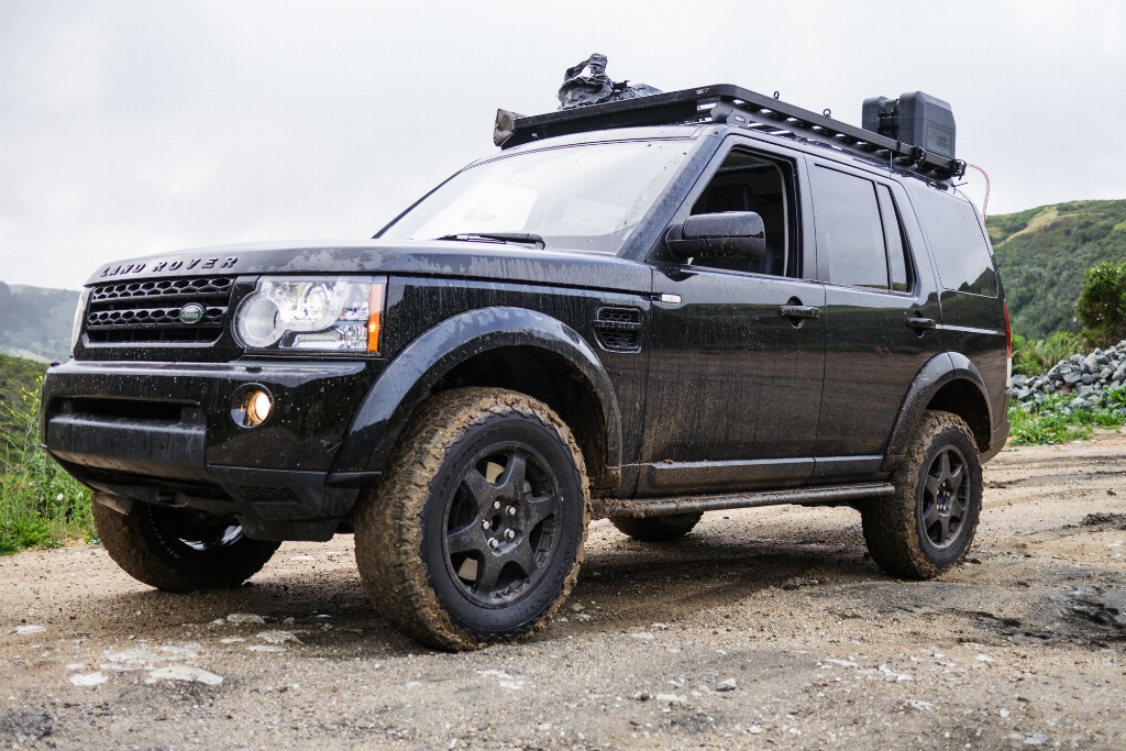

Put about 800 highway miles and about 50 off road on the new 18" Compos and BFG TA KO2's since last week.
Not surprisingly - I'm really impressed with these tires, relatively quiet and well mannered on the street and bullet proof off road.
Some rain and a "road impassable when wet" sign was a great invitation to drive a very wet old coast road in Big Sur last weekend.
A few pics of the new wheels and tires as promised:
