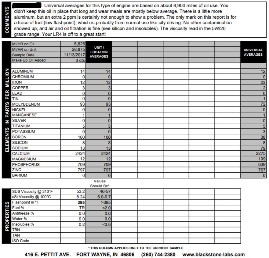

I figure I'd add my first oil analysis report. Car was manufactured in August 2013. This was the 4th oil change, done in November, about a month after warranty expired. Up until then , I have always used the LR-spec'ed Castrol Professional OE 5W-20 oil. This is my baseline analysis. I will keep track going forward with the Mobil 1 EP 5W-20 oil I put in last month. I should add that the LR4 sees city-style driving (2/3) and a few long distance trips (1/3)
Overall, not bad I guess.

I was doing a little reading on mobil1 vs mobil1 EP. What made you decide to go with EP? (Im on the regular mobil1 now, but i'd consider EP if its beneficial)

Mobil-1 EP (Extended Protection) is a "true" synthetic with Group IV/V base stocks, and is acceptable for use with extended drain intervals (10k-15kmi, approximately). If using a Mobil product for the LR4 V8, the EP would be highly preferred. This isn't the place to save a couple bucks using the non-EP. The EP should be fine for the LR4 if changed by 10kmi (IMO).
Standard Mobil-1 (non-EP) is what I consider a "fake" synthetic, with Group III base stocks, that is just a highly refined dino oil. These type of oils have similar characteristics compared to true Group IV/V synthetics, with the primary exception being they do not tolerate extended drain intervals very well. After about 5k-7kmi these oils shear down and the engine will start to "burn" oil at a fairly substantial rate (like, a quart every 1-2kmi). The "burning" problem vanishes when the oil is changed, until it again reaches the 5-7k point. The vast majority of so-called "synthetic" oils on the market in USA are Group III, and they are fine if you change your oil by ±5kmi or so. I personally would not use a Group III oil in the direct-injected AJ133 LR4 V8 engine, even if changed at 5kmi, but that's just me.
How do you tell the base stock of an oil? It's not easy, a lot of research may be required to find out. As a rough guide, most oils around $6-$8 per quart (retail price) will be Group III, while most oils $10-$12/qt (or more) are almost always Group IV/V.
To learn more than you ever wanted to know about oils, and read lengthy entertaining arguments, visit the BITOG forum: https://bobistheoilguy.com/
For Mobil-1 oils specifically, read my old post #177 at this thread: http://www.landroverworld.org/threads/diy-oil-change-for-lr4.22797/page-18#post-175734
As of this writing, the Mobil-1 product finder in USA still does not officially recommend any Mobil oils for either the 5.0L V8 or 3.0L V6 used in the LR4 in USA.

Yeah, I just got tired of not being able to source the LR spec'ed Castrol oil, so I went with the Mobil 1 EP oil (which I believe Umberto has been using for a long time with no problems - also, I believe it meets the required Ford spec). I'll be changing the oil every 6k miles or so, so I expect to be fine.
