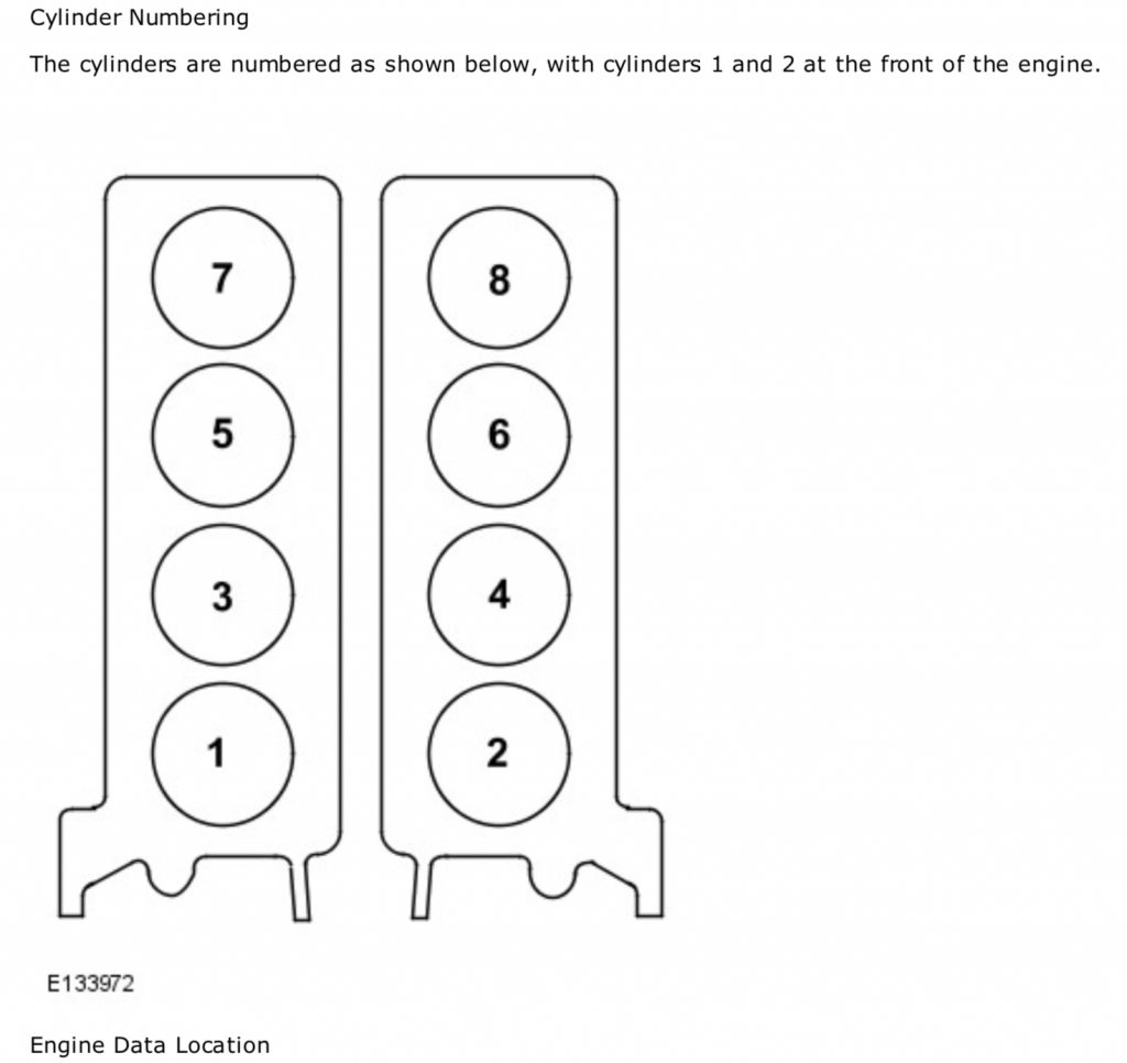

FYI... cylinder 1 is the front left according to the LR4 workshop manual.

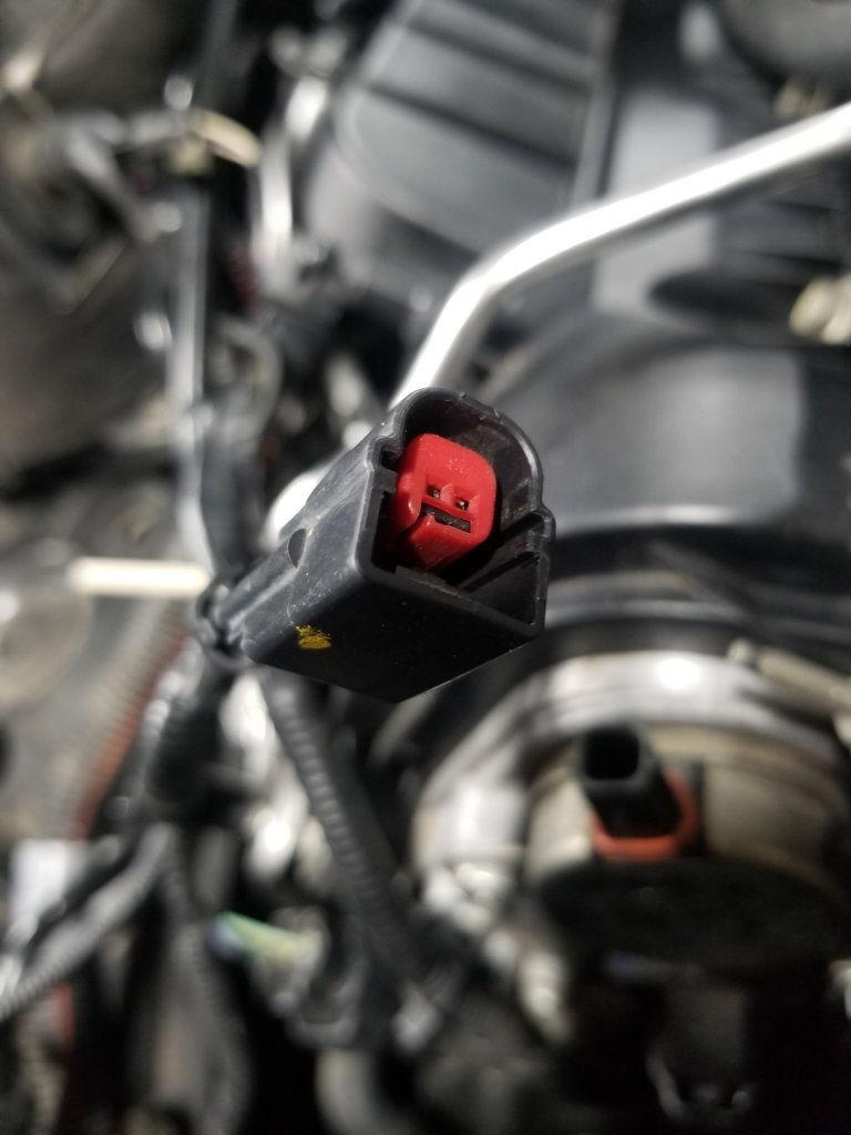

I think I found my issue. It's random that both went out at the same time, but my intake and exhaust camshaft position sensor (cps) plugs have worn out wiring where the wires meet the plugs. Bank 2 I get 12.XX on both leads of each connector on the cps, bank 1 there's a break in the wire getting inconsistent 12 readings and drops.
Does anyone know how to disassemble the plugs or remove the red center cap?

Possible help based on the Ford lineage? There is a connector in the video very similar, if not identical to the one you pictured.
